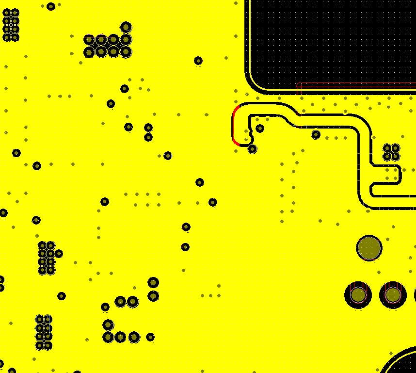

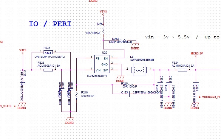

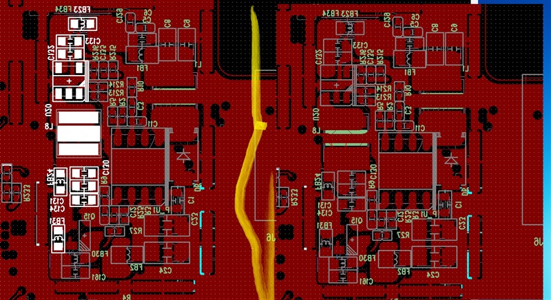

We are using TLV62565DBVR on schematics and Artwork(Botton 6 Layer & GND 5 Layer) of 6 Layer on board as a below
However, I find out that TLV62565DBVR is tiny noise sound when is running Softstart time.

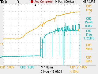

So, We measure EN(Channel 1) & Switch pin(Channel 2) when is running softstart time as a below.
Can you have to slove tiny sound like pop-up noise?

  • Hi Gerald,
    you are using a 5.6uH inductor which is not a recommended value.
    Please use an inductor with 2.2uH (see table 2 in the data sheet).
    C135: please change the feed forward capacitor to 8.2pF.
    Ivo

  • Hi Gerald,
    do you mean there is an acoustic noise you can hear when powering up the converter?
    Beside VIN and SW node, can you please also show the inductor current when powering up the device?
    Looks like the input voltage (VIN) is ramping up slowly (10ms ramp time) - can you try to ramp VIN faster?
    Ivo

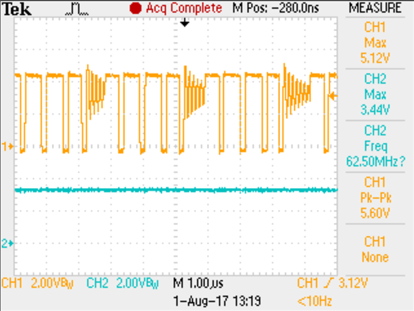

  • Hi IVO
    Thank you for your replay.
    We can heard like pop-up noise when power up and power down.
    And then, We might hear When change mode PSM to PWM and PWM to PSM mode
    Even, We can hear acoustic noise at the TLV62565EVM-179 board
    -In & Output Voltage is as a chart below
      IN(CH1) Voltage: 4.4V, Out(CH2) Voltage: 3.3V
    -SW PIN
    -Inductor current: 265mA
    Can we get more solution and information?
    Best Regards
    Gerald
  • Hi Gerald,
    your plot shows a switching frequency of about 1.3MHz, so the converter and passive components cannot be the audible noise source.
