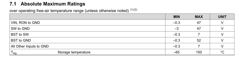

Hi, team.
In datasheet, rating of ILIM terminal is -0.3V to 7V.
But, ILIM terminal should be the same electric potential mostly with a SW terminal.
So, I think the rating of a ILIM terminal is wrong. Is it correct?
BR
