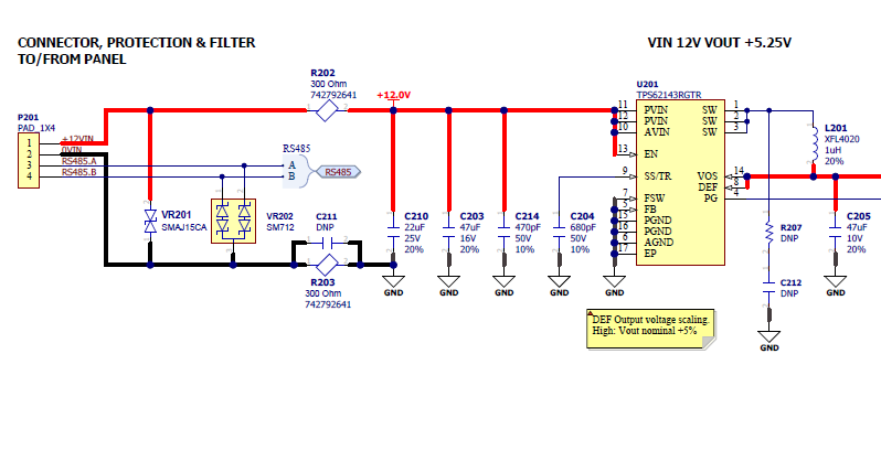

So far we were not able to see any issues with the supply to the board (12V) and the unit itself was succesfully UL certified. For protection we have transorbs but the issue doies not seem to come from external spikes. The circuit connected to the converter consumes 900mA max. Any more than that is only possible by external shorts of the provided RS485 interface as well as other gross issues in combination.

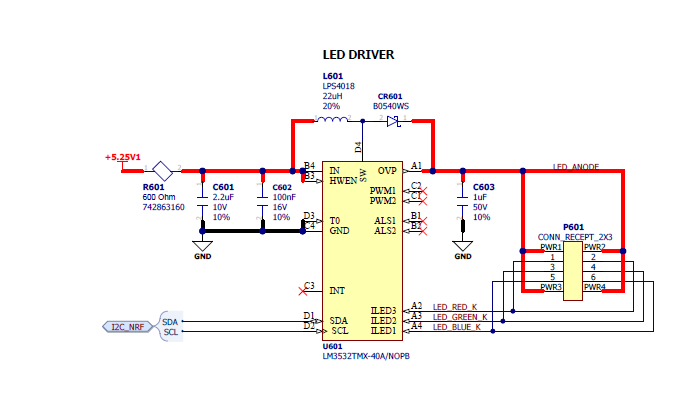

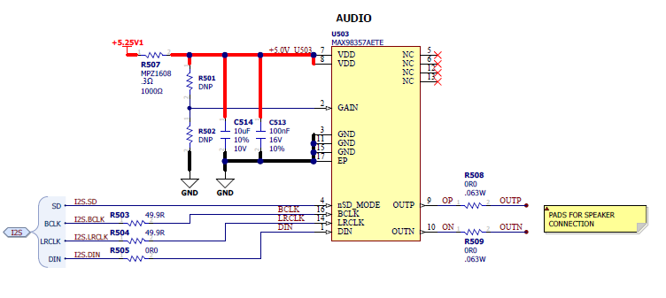

In addition I wanted to ask if the inductance of the speaker could cause a problem with the loop stability of the regulator. The supply circuit as well as the speaker driver and LED driver schematics are attached.

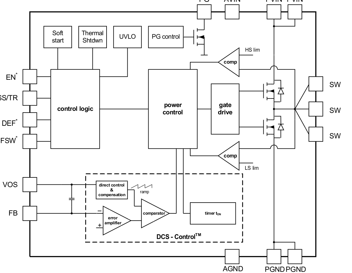

    Failures of DC/DCs are usually caused by PCB layout and/or hot-plug overshoot on Vin. If Vout goes above the abs max limit (for the VOS pin, in this case), this can also cause damage.

    The VOS pin is rated to 7V, so spikes above this could cause damage.
    You can examine the output voltage for oscillations, etc. while the audio is running to check stability. I think this will be fine.

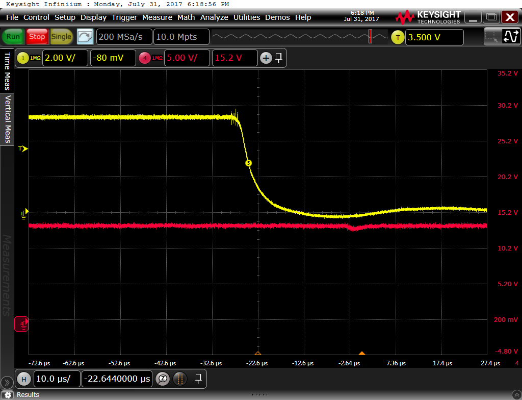

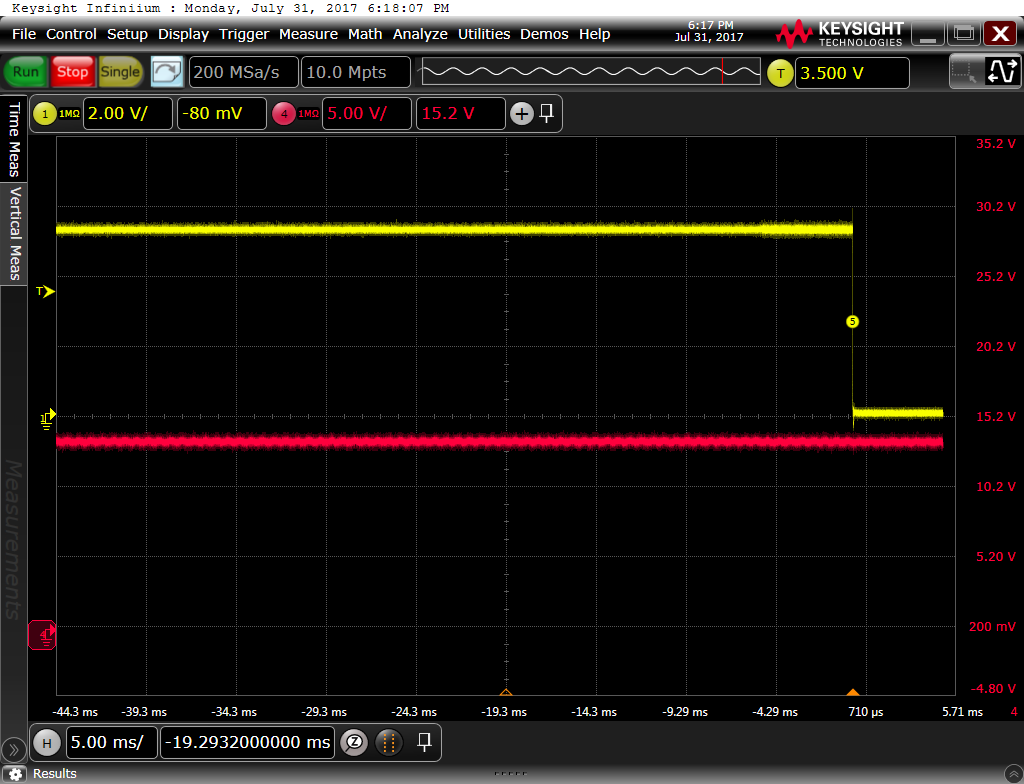

    Please see below the triggered death event. As you can see from the scope plot the 5.25V as well as the input look clean. We triggered on the falling edge of the output voltage to show us when the device died:

  • Thanks for capturing a failure. What did you have to do to cause this to happen? If anything is proprietary, go ahead and start a 'conversation' with me to discuss further.
    Are you able to fairly easily cause a failure in your lab? It's unclear from the last few posts.
    If you can cause another failure, can you trigger at ~1 usec/div and add the SW node to the scope?
