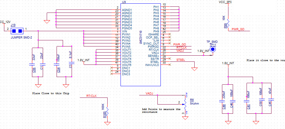

Hi TI,
I am using this buck for 4 different power generation(1.8V, 1.2V, 1.5V, 0.8V). I have trimpot at Vadj to get required vout, RT/CLK is fixed as per the datasheet for each rail . please find attached schematics for one set. After assembled on pcb, each board shows different supply issue. One board show one buck output follows input, Another one  has NO VOUT and in some other output not vary at all though we varying Vadj, we checked the Vadj pin is okay. Looked us it could be assembly issue, we replaced the faulty devices, the replaced one worked but nearby buck showing abnormal behavior, this happened with two boards which we sent to assembly house.
Assembly house using temp profile - 241 D.C for soldering. Can some one let me know which is the critical and most sensitive part of LM31710.
schematics for one set:
