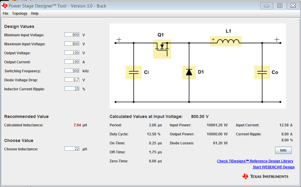

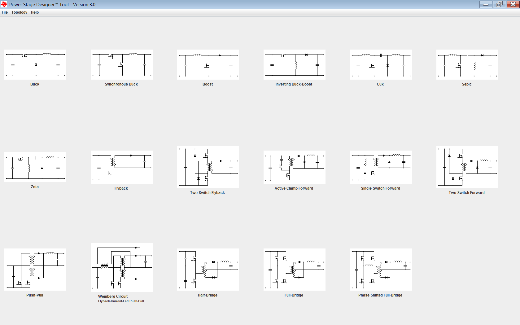

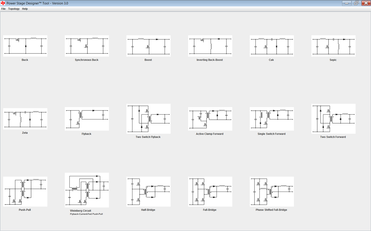

  • Hello Marko,
    Try the POWERSTAGE-DESIGNER tool.
    This allows you to experiment with different topologies.
    You enter Vin Vout Iout Fswitch and a few other parameters.
    The tool recommends a minimum inductance, calculates power stage voltages and currents.
  • O thank you,
    suck a great software. This will give me some good values to put into simulation.
    Marko
