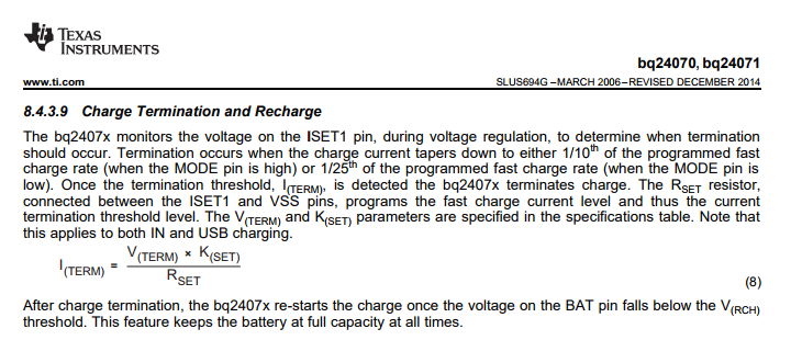

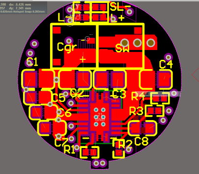

Hi all,
As my question, The Chip can not end charge when charge current under 1/10th Vset current. But the charger function works well.
So, if I want to solve these problems,how can i check the schematic?
Hi all,
Section 8.4.3.9 of the datasheet states that "After charge termination, the bq2407x re-starts the charge once the voltage on the BAT pin falls below the V(RCH) threshold. This feature keeps the battery at full capacity at all times.". If you look at the datasheet, the stated V(RCH) voltage is Vo(BAT-REG) - 0.1V. Vo(BAT-REG) = 4.2V. This means that if the battery voltage falls below 4.1V, the IC starts recharging until the battery reaches the regulation voltage of 4.2V.
