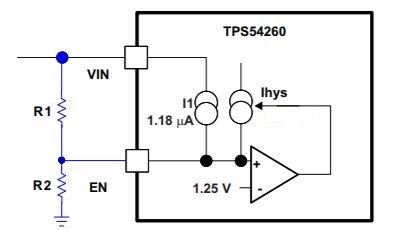

I am using TPS54260 in my design for the 3.3V conversion, The input voltage may change between : 4.5V to 16V(13V nominal);
Load current: 1A
Output voltage: 3.3V
How to calculate the enable pin voltage divider by considering input variation as well as UVLO,
Note: Convertor should be in on conditon allways.
The formulas provided in the data sheet are confusing,
pls provide some example calculations

    In your application , if you want your design to be enabled at 4.5V(Vstart)  and disabled when voltage goes below 4V (Stop) , you can program the UVLO as below :
    where ihys is 2.9uA ,  Vena is enable threshold of 1.36V and I1 is equal to 1.18uA .

    Thanks for sharing the feedback. I have calculated the design parameters based on the datasheet formulas: those are listed below, please any one verify & correct me if I am wrong:
    Input voltage:14
    Output voltage:3.3
    Load current:1A
    FSW: 1918KHz
    Rt: 54.9K
    Enable pin calculations:
    Vstart: 4.4
    Vstop:4
    RUP:121K
    Rdown:52.3K
    Feedback resistor calculation:
    R1: 182K
    R2:57.6K
    Output inductor: 6.8uH(MAG-IND,6.8uH,20%,1.6A,SMD)
    Ripple voltage: 3%
    Ripple current: 30%
    Cin: 400uF
    Cout: 220uF+10uF+10uF+10uF
    Compensatoin loop values:
    Rcom:15K+10nf
    Rajesh

    Your Max Input voltage is 16V . At 16V input and 3.3V output with Fsw-2Mhz , you end up having on time of 100nS which is lower than the typical on Time value of 135nS for this device . I recommend using lower switching frequency .
    You may use Webench for circuit design and simulation .
