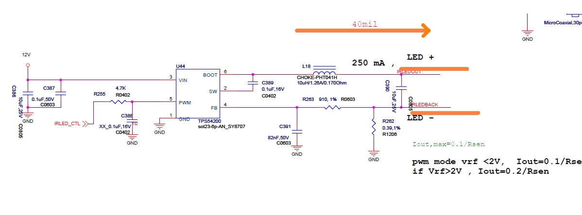

Hello Sirs,
We face an audible noise issue when using 500Hz 1.8V PWM input .
Vin is 12V
LED current is 250mA (Vref 100mV, Rsense is 0.39 ohm) . Trying to wire PWM signal to TPS54200 EVM also have same problem ... TKS !
Schematic as below ( Pls ignore boost-Cap mistake )
R255 is 4.7K , C388 is NC .
