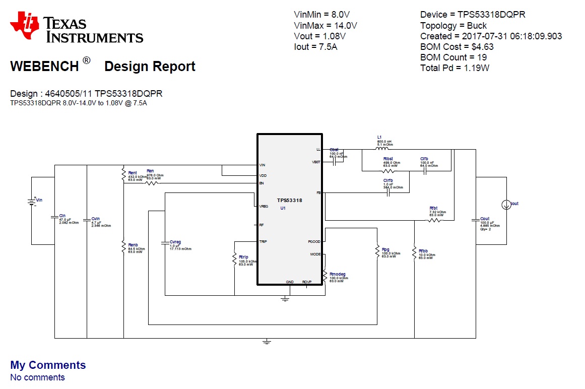

TPS53318: Comment required on designing for Processor Core Supply of 1.08V 7.5A with AVS control
Part Number: TPS53318
Dear TI
Please help me in clarifying the following in the design with TPS53318 for Processor Core Supply of 1.08V, 7.5A with AVS control. (a) I hope this device can support the AVS control from Processor, which varies in the range of Vo-0.2V to Vo+0.2V  (b) Please confirm the AVS control provided as shown in the schematic picture, which is updated from the design generated from web-bench without AVS control.
The web-bench in puts and output is also given below for reference
Thanks and Regards
