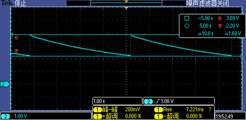

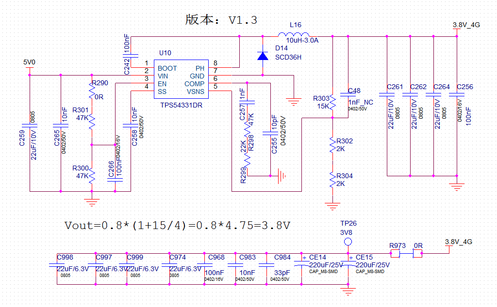

I want to add extra load but how much resistance load do I need to improve the low dropout of the TPS54331?
In case of  Vin=5V and Vout=3.8V  and no load ,the output voltage keeps changing.  I wonder how much load do I need to keep the output voltage stable at 3.8V.
