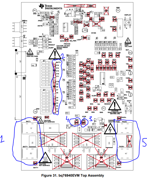

2. Presently I can detect 0x08 address from my raspberry pi  when I connect to i2c port and 0x0b address when I connect with SMBus port. I want to read the cell voltage, SOC and temperature values which are showing in the bqstudio. What are the registers which we need to call to read the value. What should be the data memory smb configuration setting. Below you can see the register values are having an lock icon.Does that mean its not accessable.

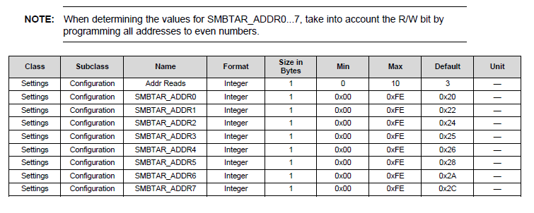

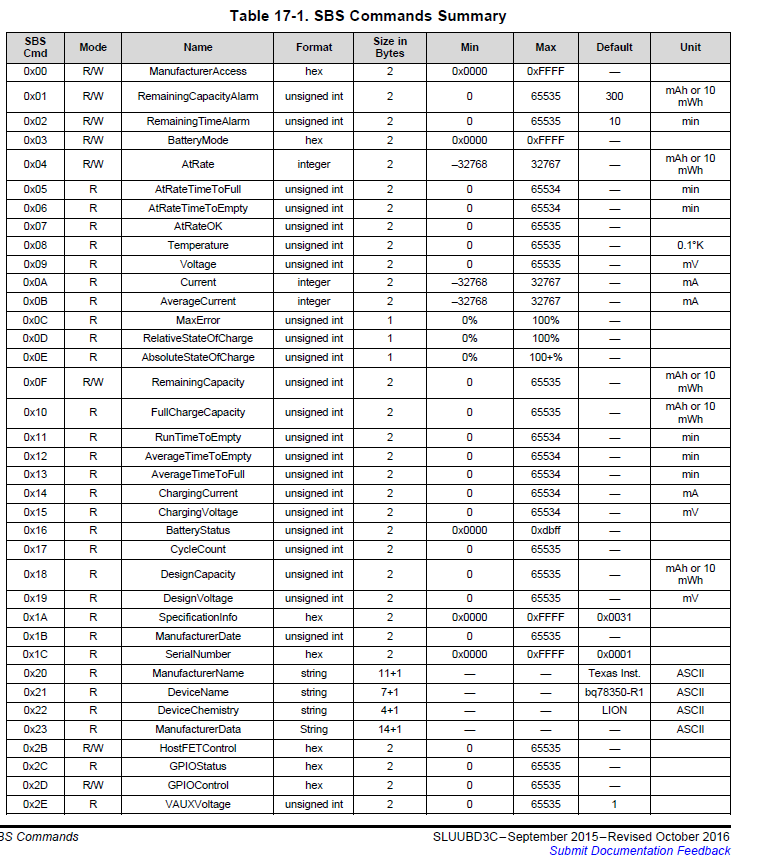

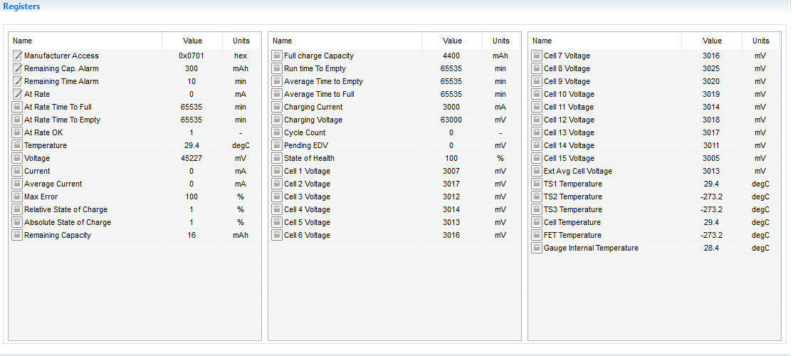

3. In gauge calibration, I have calibrated voltage, temperature and current offset. In case I am unable to do the current gain calibration does it stop the communication? do I need to set some control flag. I dont have a power resistor currently to do the current gain calibration with constant current flow. Is that the step which should be done prior to do communication. Is there some method to bypass it.
4. What are these addresses?Are they which I need to access? .
5. I am following the sluubd3 manual. Do we need to read the entire data inside these addresses

  • (1) refer to the SLUUBD3C for the latest updates on bq78350-R1.
    (2) bq78350-R1 communicates with the bq769x0(AFE) via I2C.
    (3) If using the bq78350-R1 with your host, its only via the SMB. The host cannot access the I2C communication line; its locked out.
    (4) The data flash Table 19- has AFE's HW protection and gauge's registers. As per example, 0x41DA (cell1 voltage), Ox41DC(cell2 voltage).......0x41F6 for cell15 voltage.
    To learn the AFE registers and its interaction, access the bq769x0 directly by using the provided AFE GUI and EV2300 controller; Disable the bq78350 completely via the jumper on the EVM.
    hope this gets you going.

    During the process of communicating with raspberry pi 3, there is a problem that the bqstudio is losing communication with 78350-R1 in approx 12 sec.
    I am clueless how to debug. Bqstudio shows CUV bit high since the cell voltage 6 is showing 61mV instead of 3000mV. Can I reset the EVM kit with some command.
    kindly suggest
    Dripta
  • The communication make be affected due to bq78350 being bad. Is the cell actually that low at the pin?
  • Hi vish
    Thanks for replying.
    When I measure the voltage across each cell it gives me correct value but for some reason charge voltage is lower by 3V around 42V. The evm is under simulation with input power supply of 45V. Average voltage should be 3V for each cell. I dunno how yo debug in such situation. Kind of stuck since 2 weeks.
  • Hi Vish
    When I measure the voltages at the marked positions in gives me following values
    1. 45V
    2. 45V(across C0 and C15)
    3. 41.2V(across C15 and TP11CHG)
    4. 45V( across C15 and TP10DSG)
    5. Across Pack+,Pack- 37.3V
    When I measure the voltages across each each cell
    Cell 1: C0,C1 3.1V
    Cell 2: C0,C2 6.2V
    Cell 3 : C0, C3 9.3V
    Cell 4: C0, C4  12.4V
    Cell 5: C0, C5 15.5V
    Cell 6:C0, C6 17V
    Cell 7:C0,C7 20.18V
    Cell 8:C0,C8 23.28V
    Cell 9: C0,C9 26.4V
    Cell 10: C0,C10 29.5V
    Cell 11: C0,C11 32.6V
    Cell 12: C0,C12 35.7V
    Cell 13: C0,C13 38.8V
    Cell 14:C0,C14 41.9V
    Cell 15: C0,C15 45V
    Please suggest
    Dripta Ray
  • refer CHG to PACK-. I note 2.5V across the Cell5/Cell6 at the boundary. Ref DSG to BAT1. sounds like both FETS are off. The voltage being measured @ CHG pin is the internal 1MEG(pulldown) + R8+R9 in series with the measurement voltmeter. check what is hooked across as a load on the PACK+/PACk- So the 2.8-3.2V drop can be accounted for.
  • Hi Vish
    We did not connect any load to the PACK+/PACK- terminals. There is no load hooked to the EVM kit. Is there any other reason what could lead to this drop in voltage.
    Dripta Ray
