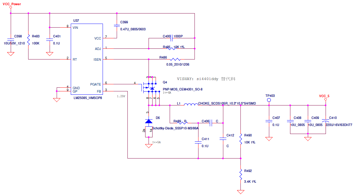

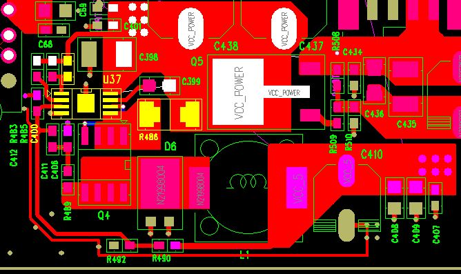

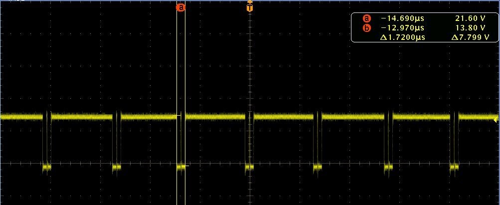

Hi there,
I am having trouble with LM28085; it turns off the MOS for 100ns and turns it back on.  Is there any reason LM25085 behaves like that?  Thank you
regards,
