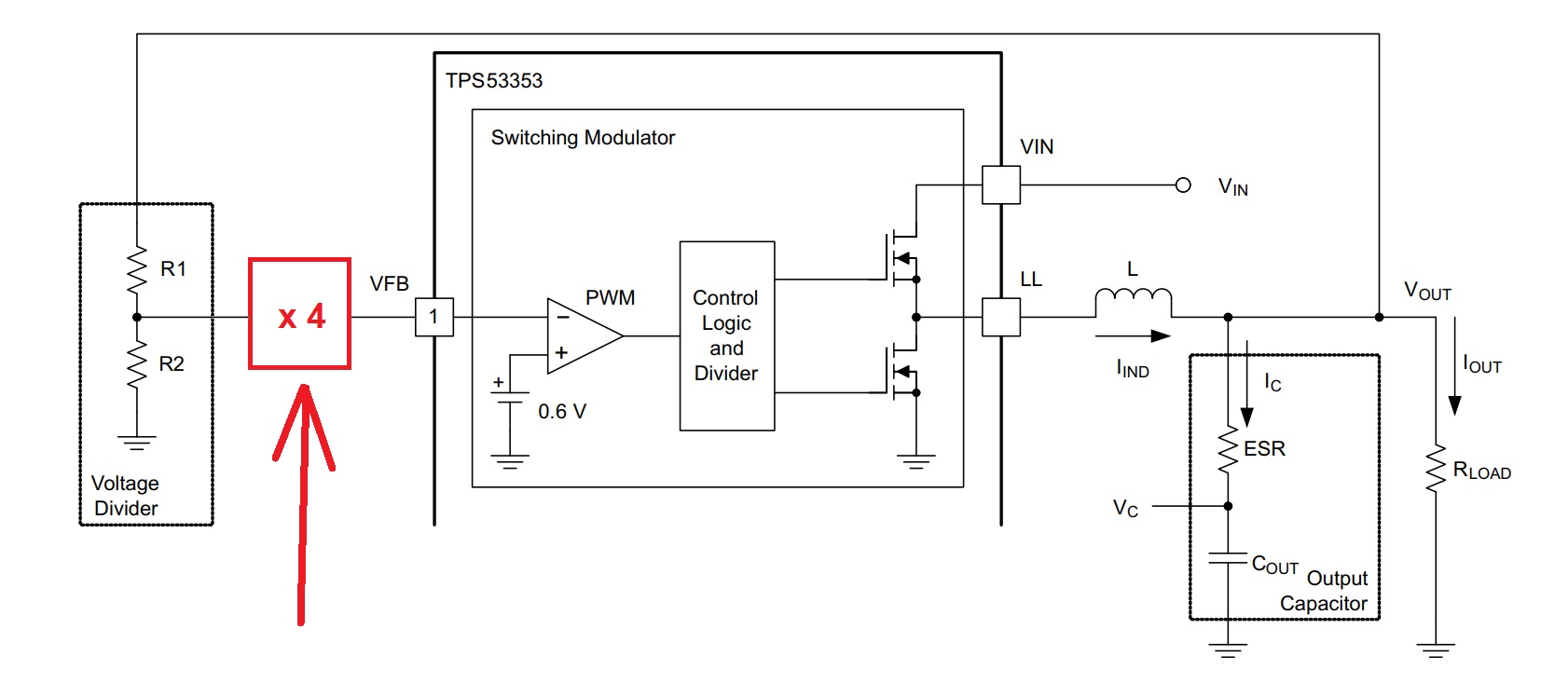

My question is about the possibility of having Vout lower than 0.6V,
Let's say that I need an output of about 0.25V
the VFB input is compared inside the chip with the reference (0.6V), to adjust a PWM which adjust in its turn the output voltage,
Let's say that I choose the external components to have 1V output (for example). and I add a stage at the VFB that multiply the voltage by 4
So th VFB will be 4V.
In this case, will the DC DC converter adjust the PWM to have an output voltage of 0.25V (1V/4)?
I attached an image to more explain the question.
thanks.
  • Although theoretically it might be work, I do not think it is a good idea.
    Placing anything in the feedback loop of the regulator an cause instability.
    Also, you may have issues with min on-time with such a low output voltage depending on you input voltage.
    You can experiment by lifting up the bottom FB resistor and putting a voltage on that node and adjusting
    for you output voltage.
  • I'll look at this later today or tomorrow and let you know.
  • Theoretically you could use an external error amplifier and configure it so that its output equals 0.6 V when the input equals whatever lower voltage you are trying to achieve. Another approach would be to inject current into the FB node. You can do that with a resistor between VFB and an appropriate voltage source.
