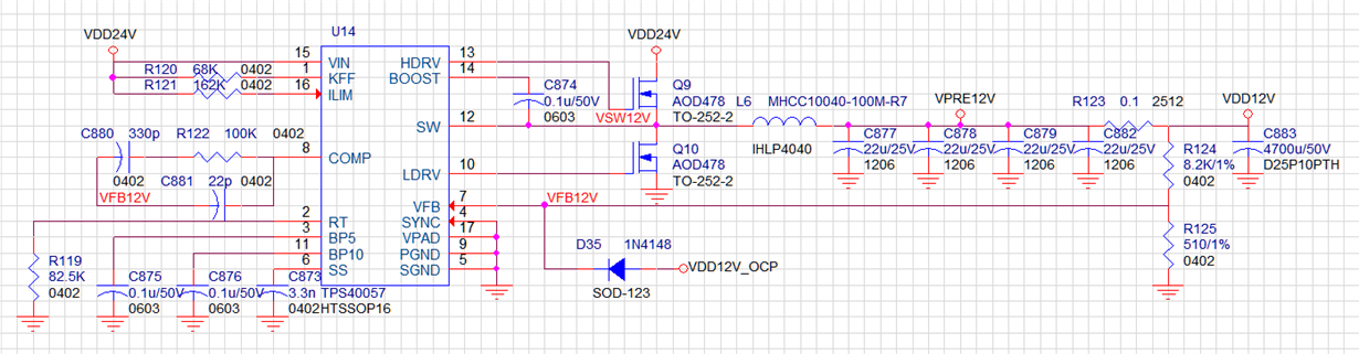

My new board uses TPS40057 as the main switch controller. The schematic follows the recommended design in figure 15 in TPS40055.pdf, except some parts changed:
(1) MOSFET: AOD478, 150mR Rds_on
(2) RILIM: set to 162KR
(3) RKFF: set to 68KR
(4) Inductor: MHCC10040-100M-R7, the saturated current is larger than 8A.
All other parts are almost the same, except for the input and output capacitors, and that the input voltage is between 16V to 28V and the output voltage is 12V.
In our design we are requested to provide clean power to a device and it's required to withstand up to 20ms power loss, so the input capacitor reaches 10000uF and the output capacitor reaches 5000uF.
The ripple rejection is done by adding several 10uF MLCC directly after the inductor.

    Please can you share a schematic?  Thank you in advance.
    Kind regards,
    David Baba.
  • Thanks very much. Here's the schematic:
    Part R123 and D35 is used for back-end current limit however I've tested TPS40057 current limit function so it's useless and will be removed then. This resistor consumps a lot power (the efficiency would be reduced to 60% at 6A load).
    The MOSFET RDON is 0.15V typical so the current limit resistor is calculated to be 150K. 162K is used actually.
    In the test board D35 is not populated; VFB is around 0.6V during heavy load (~5A) when output voltage only reaches 10.4V, and 0.68V during light (~1A) load when output voltage reaches 11.5V. I'll try to capture several waveforms later.
  • Thanks. I've posted the schematic. If there's anything I can do to help identify the problem, please leave me a message.
    I suspect, you are hitting current limit?  Have you tried increasing the Rlim resistor to increase the current limit set point?  The current limit can be layout sensitive.
    Have you an LC filter on the 24V input bus, if so, this will need to be dampened?  this is typically implemented with a large cap with a relatively high ESR.  If not, I suspect the traces of Vin and Switch are not optimal in layout (not routed differential to their respective pins, causing excessive ringing and premature tripping of current limit?

  • Hi!
    Thank you very much for your help.
    My PCB does use a common-mode inductor and TVS diode for input protection. Previous design uses TPS54331 however it is very easy to get burnt.
    I checked the design and found out the SS needs to be extended - I selected 0.47uF and it boots happily with 6A load. When SS is ok, selected RKFF and RILIM seems to work fine, and the output is able to keep 12V.
    Four 10uF/50V MLCCs are tied directly to D of the high side MOSFET, and two 4700uF aluminium caps around the power plane, so there won't be much ripple voltage in the VIN. There're also four 22uF/25V MLCCs at the out pin of the inductor. The output ripple is analyzed to be +-7.5mV when idle and at heavy load.
