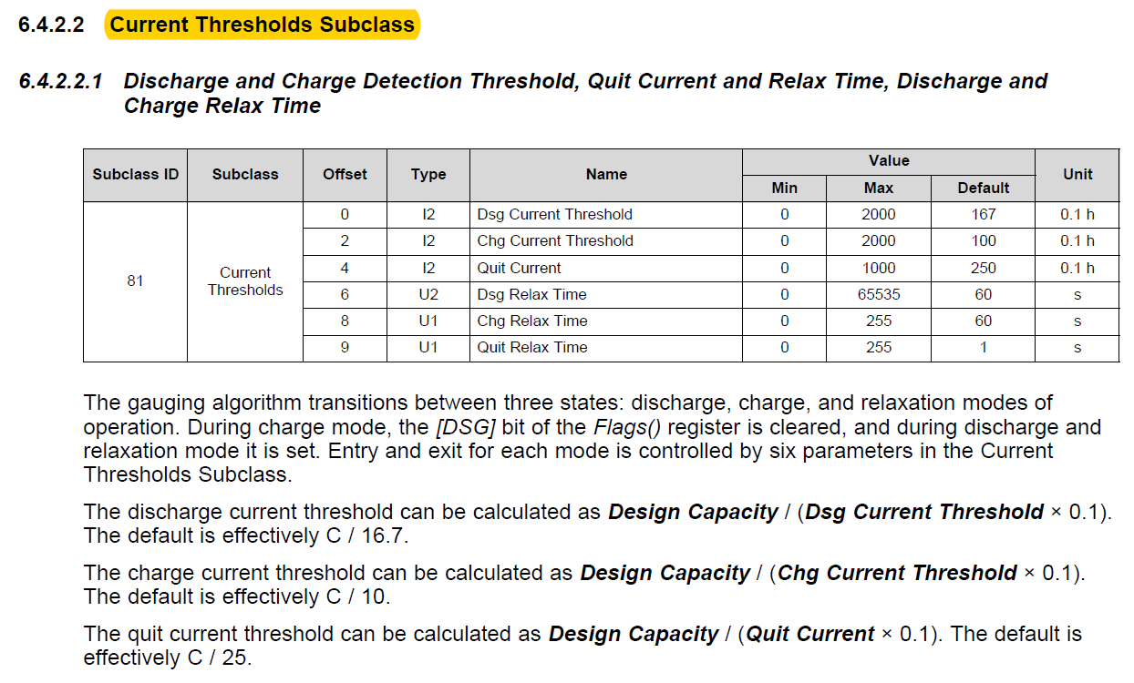

when I write the charge current threshold, do I need some calculate like below?
this picture is from bq27421 technical reference. But I don't see it from bq26425?

The units are in terms of 0.1 hour rate. This means if you would like to set the discharge current threshold to 100 mA for a 2000 mAh battery, that means the C-rate is C/20. Which means you will need to write 200 to the Discharge current threshold. The calculation is done as 200 *0.1 = 20. Capacity / 20.
