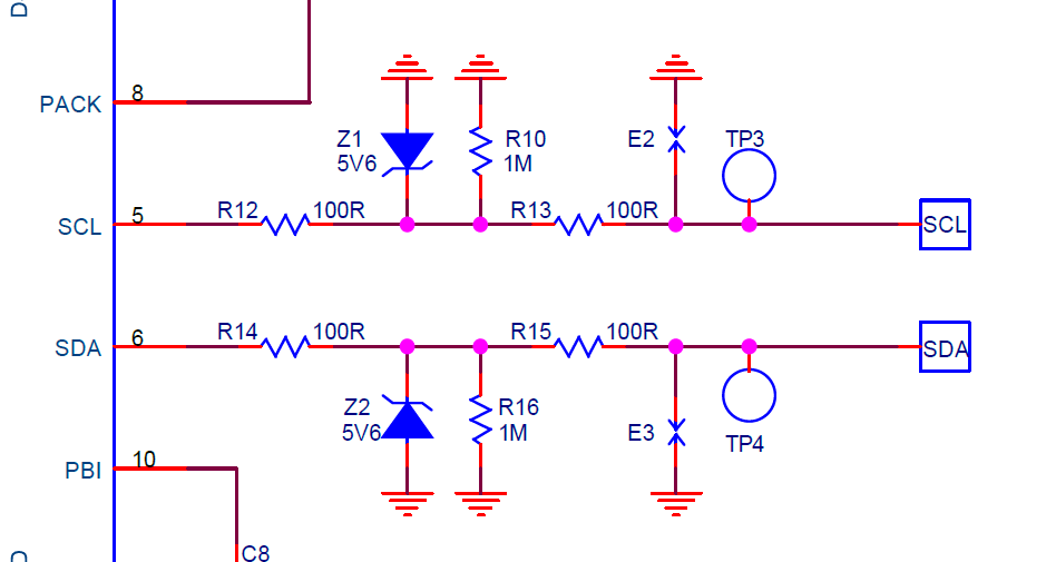

BQ28Z610: I2C discommunication
Part Number: BQ28Z610
Hi all,
I have a problem that I2C discommunication at 200kHz. Pull high resistor is 2kohm and other componet as below. And I found around 75uS~100uS clocl stretch on waveform. Does the phenomenon is right? Next step I will enable 400kHz mode at I2C configure. If you have any experience on this problem, please let me know, thank you.
