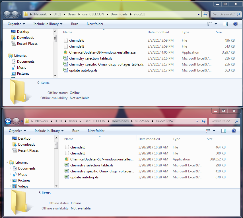

I'm running bq Evaluation software V0.9.90 and the current Chem Updater version is 464.  I'm trying to update my Chem ID database using the files in "Gas Gauge Chemistry Updater Setup v5.84 (Rev. FJ) 03AUG2017".   When I run the "ChemicalUpdater-584-windows-installer.exe" file, everything seems to go fine.  But when I go into the Eval software and go the Chemistry Selection Table, the version is still 464 and nothing was updated.  Can someone help me get the Chem ID's updated?

  • I found an older installer file "557" and this file installed and updated the Chem ID database but file "584" will not update the Chem database within the bqEVSW.
    See above image.
    The flies shown on top are for the "584" installer and the files shown on the bottom are for the "557" installer.
    You will notice that the .exe file for "584" is 3,997KB and the .exe for "557" is 309,052KB.  That is quite a bit of difference in size of these files.  Not sure if this has anything to do with the issue or not.  Just wanted to share if it helps.
    Kevin
  • TI recently found that bqStudio could only support chemistry updater files that have less than 2000 ChemIDs and the latest datasbases exceeded this number. They released new bqStudio programs to allow the  database to support more ChemIDs. The bqEVSW program may have the same problem. I will check with TI to see if this could be the problem.
  • I think you're on to something.  I looked at the Excel spreadsheet.  The "584" file has 2015 Chem ID's and the "557" file as 1883 Chem ID's.  Thank you for looking into this.  Kevin
  • Hello.....have you been able to get a response from TI?.......thanks.
  • TI said that the version 584 chemistry database is corrupted and needs to be rebuilt. I do not have a schedule on when it will be updated. The bqEVSW program should be okay.
