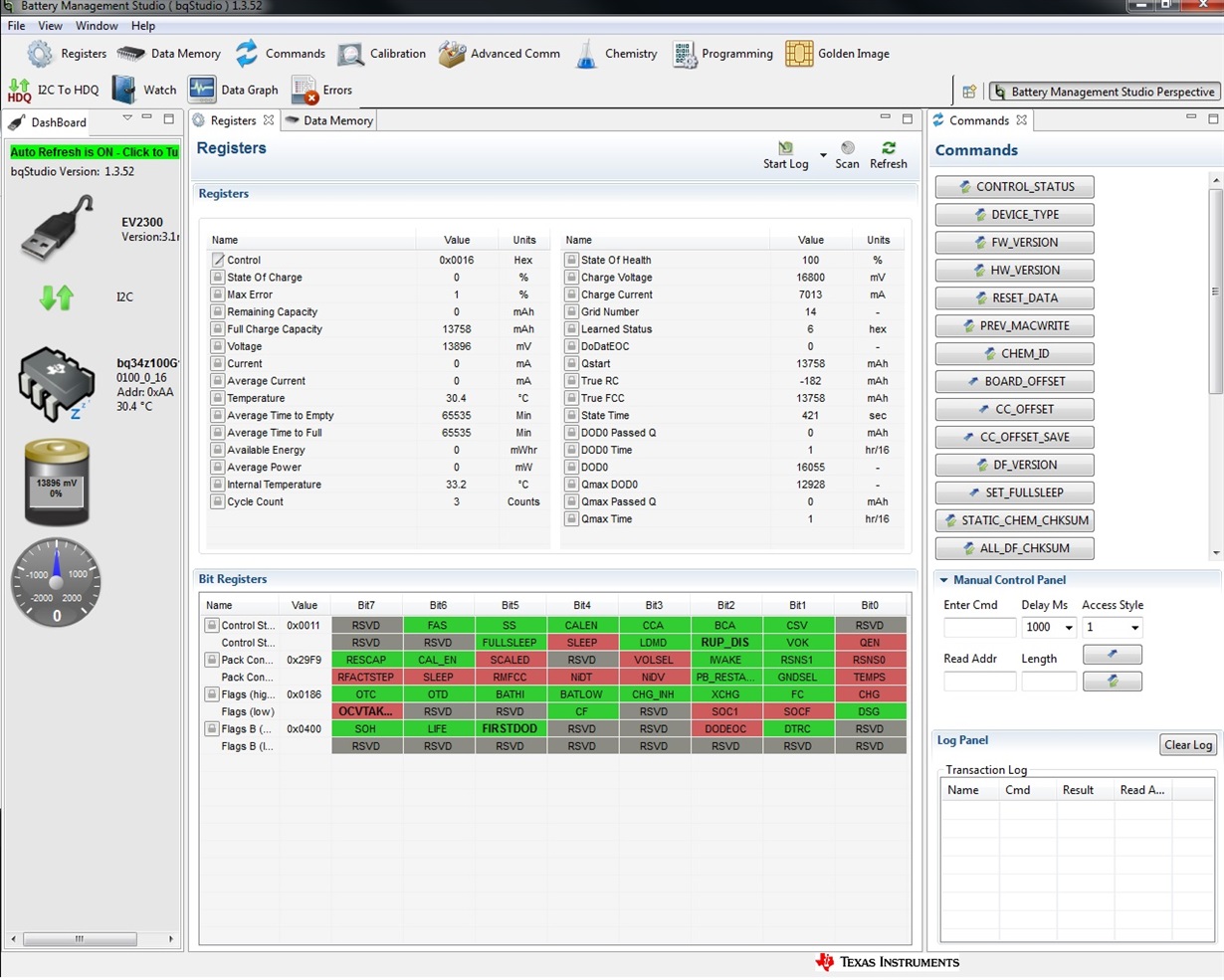

Hi. I tried to install .srec file to the bq34z100-g1. It succeeds with downloading it but fails with to execute. When ever I press the "Execute FW" it shows Failed to execute firmware - no acknowledge from device.
I noticed that parameters in data memory have changed anyway.
any advice? Did the fw execution happened or not?

  • The bq34z100-G1 uses I2C address AA when in Normal mode and I2C address 16 when in ROM mode. You can try reading register 00 using each of these addresses and see if one of them acknowledges. That will indicate which mode the gauge is in. You can check the external thermistor with an oscilloscope to see whether the firmware is running. It should pulse every 1s. If the Execute button does not return the gauge to Normal mode, then try removing and reconnecting the battery. This will power-up reset the device.

    So the device is in Normal mode because I see in BqStudio the address is AA. I checked it in the way you described too, it ACKed 0xAA and not 0x16.
    Actually I did not see the pulses, but when I heated the thermistor a bit there was temperature change in the Bqstudio screen.
    I tried to remove the battery and reconect but FW execute button still shows "Failed to execute firmware - no acknowledge from device"
    I guess the FW is running ?

  • The bqHiProduction setup program can be downloaded from the bq34z100-G1 website now. If the gauge is reporting parameters, then the firmware must be running. Maybe you have the internal temp sensor selected and this is why the thermistor is not pulsing. Can you provide a screenshot of the bqStudio screen and a gg file from the device. That may provide some clues.

    The external temperature measurements are working because, I put something hot next to thermistor and saw immediate temperature increase in Bqstudio window.
    I think I will test now is the fuel gauge working properly by doing full discharge/charge cycle. Anyway, here is the GG file and screen from Bqstudio. I will report back if the fuel gauge is working or not.
    uzkopeta golden faila neierakstitas fw gg fails.gg.rar
  • The screen looks like the like the gauge is running. I checked your gg file and it looks okay as well. The RM looks low for a 3475mV cell voltage. What ChemID are you using? You can try setting the Avg I Last Run to -200mA in the data flash and reset the device to see whether it shows any capacity. The lighter current will allow more capacity and the reset will force a simulation.

    Chem Id is 2017.
    The capacity of pack it self is actually 4times more than shown. The current measured actually is 4 times higher. But that's ok because if i remember correctly this gauge could not be used with that high capacity. Anyway this golden file was exported from battery pack that works well so it should run without problems, I just did not know how to install this golden file in brand new bq34z100-g1 and make it run. But thanks to you I guess I succeed. I still have to check if gauging is working, but I will have to wait for that because of the cell failure.
