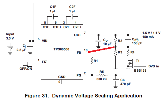

There's an error on page 19 in figure 31 - see the red line in the following image:
Without the connection to FB this can not work.
