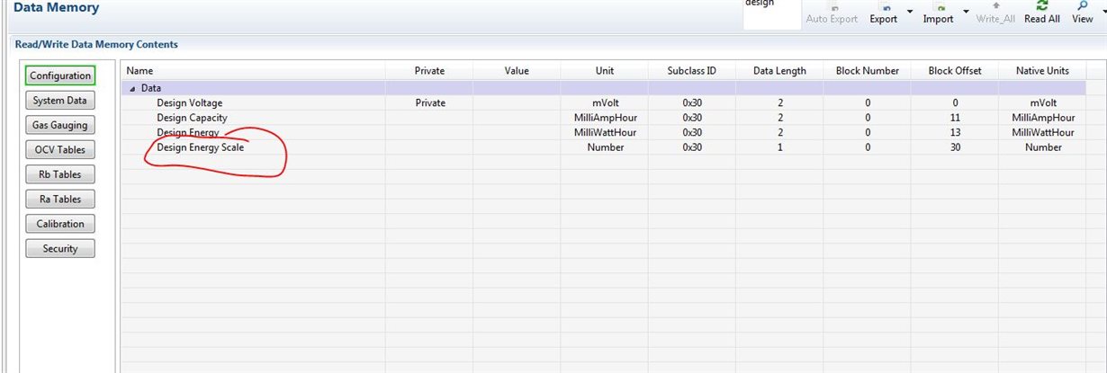

  • Hello.Please give advice. We use 34z100 in conjunction with the Arduino to read data via I2C interface. Is it possible to read the parameter Design Energy Scale? Sorry for bad English.
  • Yes. See app note below:
    www.ti.com/.../slua790.pdf
    thanks
    Onyx
  • Thank you Onyx, we have this Datasheet. We can read the commands listed in the commands table dataset SLUSBZ5B - State of Charge, Voltage, Current, Remaining Capacity, etc., because in some datasheets are command codes and addresses at which to execute the query.. the table data flash summary (SLUSBZ5B, p. 25) indicates that for the parameter Design Energy Scale subclass ID=48 (0x30), offset=30. But to consider this parameter we have does not work..Please, Tell me what command and what register it is possible to consider the parameter Design Energy Scale
  • I found a solution, thanks. Register 5E
  • see the subclass id and data length. Bqstudio has this info. To view this format go to windows->preferences->all global settings->show advanced views.
    thanks
    Onyx

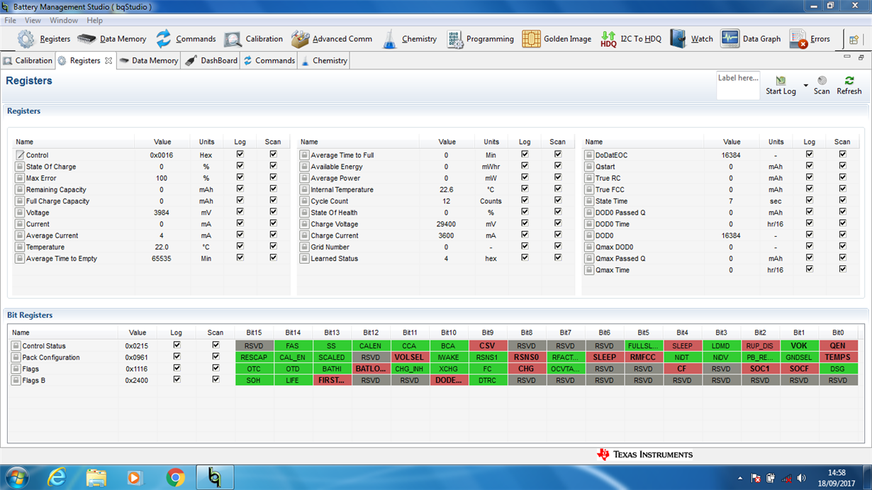

  • Did you program the default srec file and the ChemID into the pack before importing the modified gg file? The default srec file has to be programmed to the device to reset IT.
  • If I've understood correctly, then yes, I've programmed the default srec and Chem ID. Please see the screenshots attached.
    Having messed up yesterday and locked myself out of the thread, I've gone back to an earlier post to try to continue. You asked for a screen shot of the registers page. Please see below.
    Screenshots.zip
  • The screenshots show that the flash is not updating. Please provide a screenshot of the full screen with the Registers screen. (main screen)
  • Sorry, I think I hit the "resolved my issue" by mistake.
    Screenshot attached as requested.
