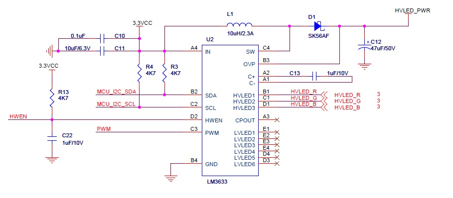

Dear all,
I can not get high voltage (+16V) at C12 (COUT) while power-on the LM3633.
The voltage measured on C12 is just 3.3V.
Is there any software procedure should be configured firstly? Please.
-Alan
Hi Alan,
My apology for misreading your post, yes there is an initialization sequence required top turn on the boost output.
The initialization sequence is:
0x10 = 0x00 ; assign leds to control bank A
0x28 = 0x07 ; enable boost feedback on HVLED1,2,3
0x2D = 0x03 ; OVP = 24V, fsw=1MHz
0x2F = 0x0D ; PWM Zero Detect = Enabled, PWM Polarity = Active High, Control B PWM = Disabled, Control A PWM = Enabled
0x2B = 0x01 ; Enable Control Bank A
0x40 = (non-zero value) ; Control A Brightness LSB, range 0 to 7
0x41 = (non-zero value) ; Control A Brightness MSB, range 0 to 255
If PWM is low boost will remain off until you apply PWM pulse > 750 nsec.
Randy
Hi Alan,
The 47 uF capacitor on SW pin will prevent the boost from operating properly, it must be replaced with a 1 uF cap.
Randy
