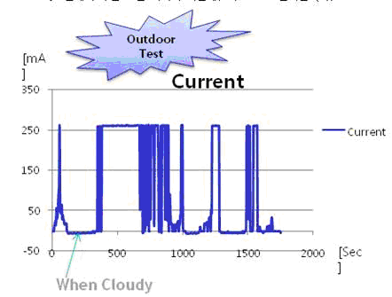

Question:  Charging Current change by MPPT.
Would you let me know why following test result happen depends on charging current limit change?
1.       Test 1.
+ Test Condition.
- MPPT Voltage : 9.5V
- Current limit : 260mA (Sense Resistor : 150mohm)
+ Result
- In cloudy condition charging current observed drop to be 0mA from 260mA soon.
- Mr. P think it should charge with N * 10 mA (like 20 mA, 30mA or 50mA)

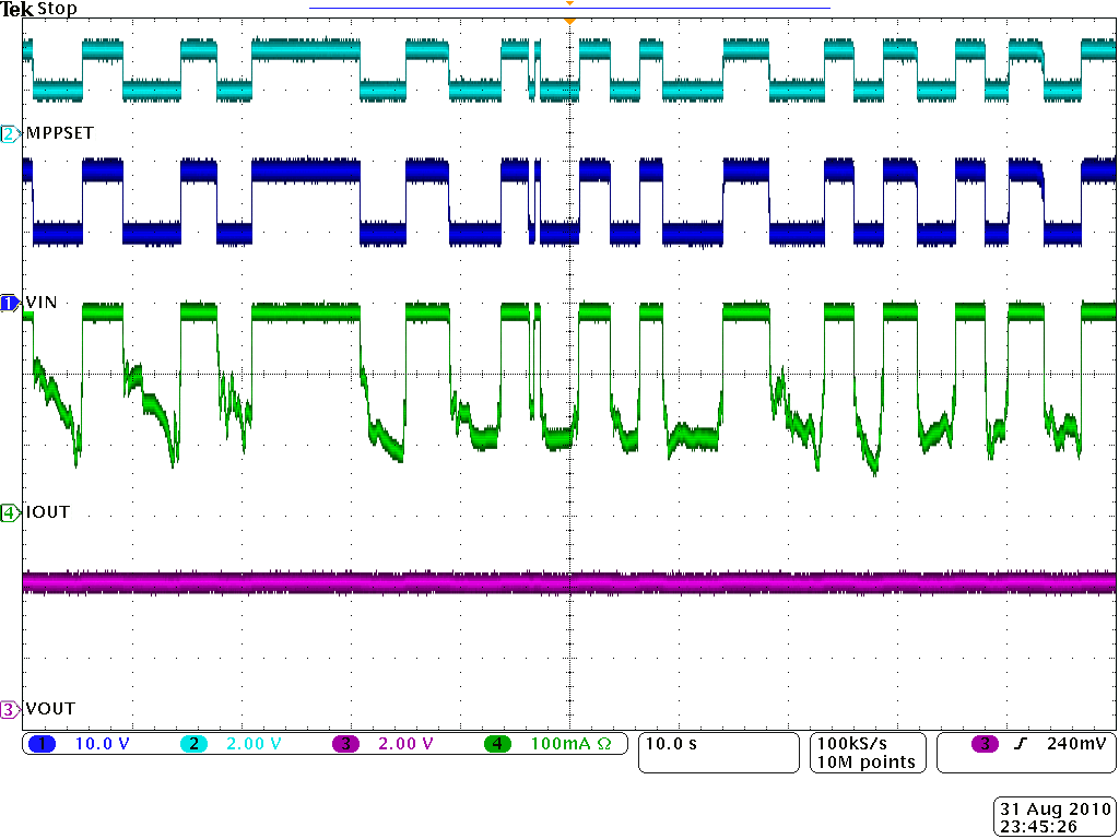

  • BQ24650 achieves MPPT function through a close-coop control by detecting the MPPSET voltage.

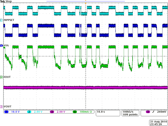

    I modified the bq24650EVM to set 260mA charge current and have 9.5V as VMPP to charge 2-cell battery. I set the input power supply to be 11V with 0.4A current limit to simulate the solar-panel. Using another resistor load connect at VSYS-GND to overload the input power, I can see the charge current decreases steadily from 260mA to 0 (disable termination) while input voltage is constant at 9.5V.
    I can not duplicate the customer issue on EVM.
    Suggestion:
    1, verify the test on EVM without the temperature compensation. (Test 2 in above email must be wrong, 50mOhm gives 800mA Ichg instead of 80mA)
    2, observe the Vin while we see charge current drops to 0 directly, make sure no other reason collapse the charger input.
    3, when using a real solar panel, reduce the light brightness slowly to avoid solar panel output collapse due to weak light.

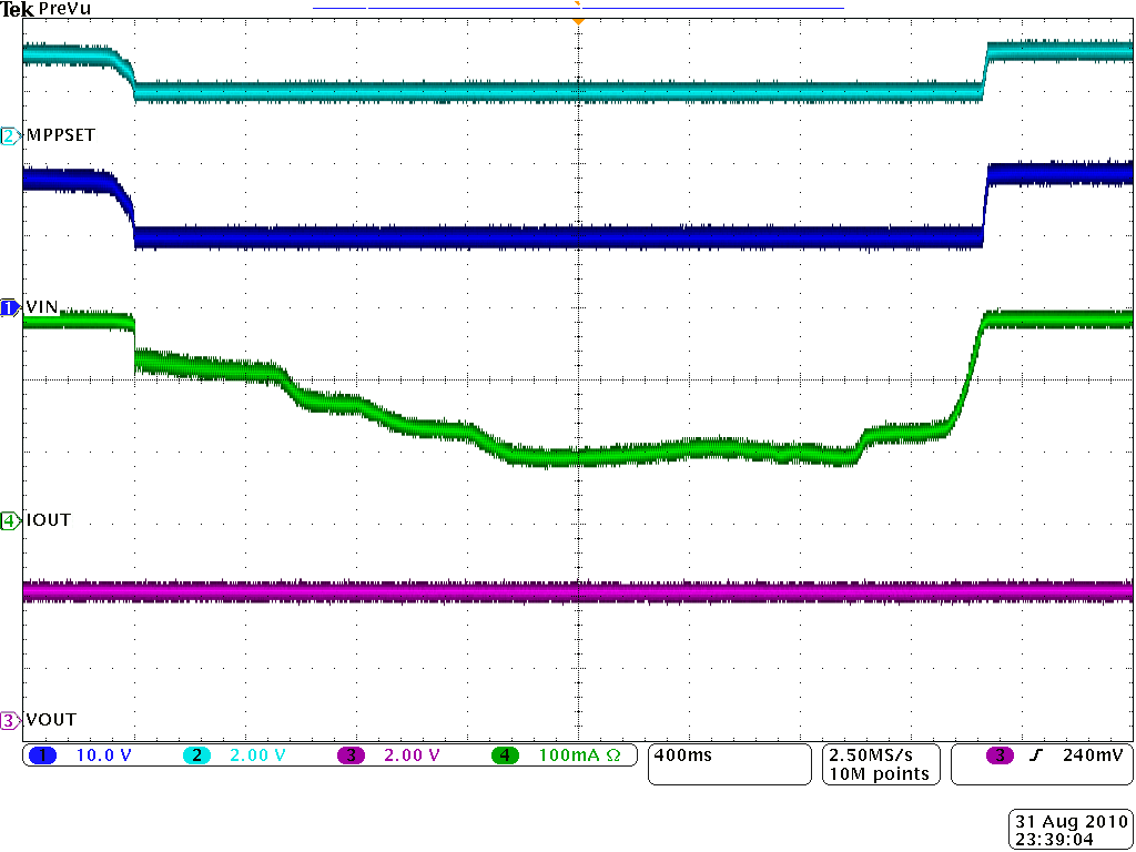

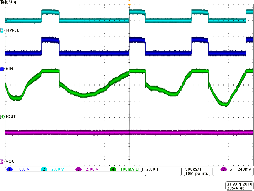

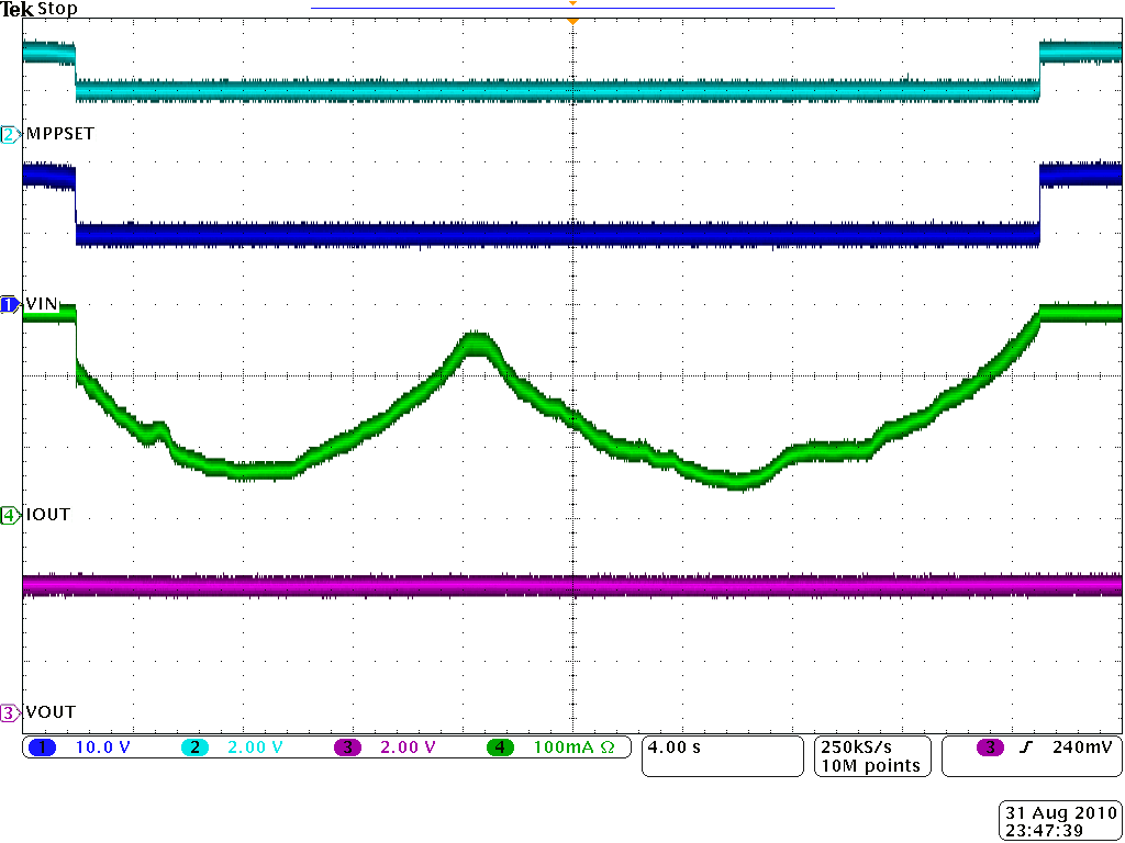

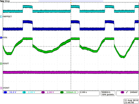

  • By changing the angle between the light and panel and/or inserting a paper (with hole) to partially block the light, we can simulate the cloudy/sunny condition.
    Following are some test waveforms with real solar-panel as customer required. We can see the MPPT works stable.
    Please double check the work condition and provide schematic/waveforms.
    1) with and without solar panel temperature compensation to verify if it's a temperature compensation issue.
    2) check waveforms to see if it's not a suitable MPP point setting. The solar panel might run out of the kneel-point and collapse.
  • It turned out customer’s solar module has a problem making the charging current up and down abruptly during the operation.
    The customer has agreed that this is not our device issue.
