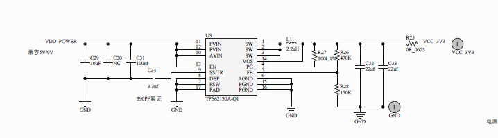

TPS62130A: The TPS62130a cannot be started and there have no output when the load is 2A
Part Number: TPS62130A
Other Parts Discussed in Thread: TPS62135
INPUT:5-10V
OUTPUT:3.3V/2.5A
Question:
         The TPS62130a cannot be started and there have no output when the load is 2A, the duty cycle is very small . But after the output is be setup, the load can change form 0-2.5A,the work of tps26130a is normal
the sch is below
