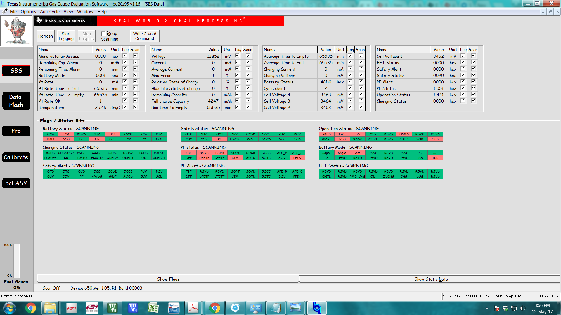

    Thanks for your reply. I have already installed bqstudio setup for bq20z95 IC to read 4 cell battery. It works good. Now Iam using bq78350 IC for 7 cell battery. The bqstudio setup shows only voltages of 4 cells instead of 7 cells. The setup does not identify bq78350 also. I need exact bqstudio setup for bq78350 IC. When Iam trying to download from the product website, I got software of bq76940 IC. Please send me the bqstudio setup for Bq78350.

  • Could you send a screenshot of the GUI? The bqStudio program does not support the bq20z95, so there may be confusion as to which tool you are using. The bq20z95 uses the older bqEVSW program, where the bq78350 uses bqStudio. Also, I forgot to mention earlier about SMBus address. While you can configure different SMBus addresses for the bq78350, I think that the bqStudio tool only supports SMBus address 16.
    I have attached the GUI screenshot which I used for bq20z95 IC.

  • The screenshot is for the older bqEVSW program and it does not support the bq78350 device. You indicated that you submitted a request to download bqStudio. Did you have issues with downloading it and getting it set up?
