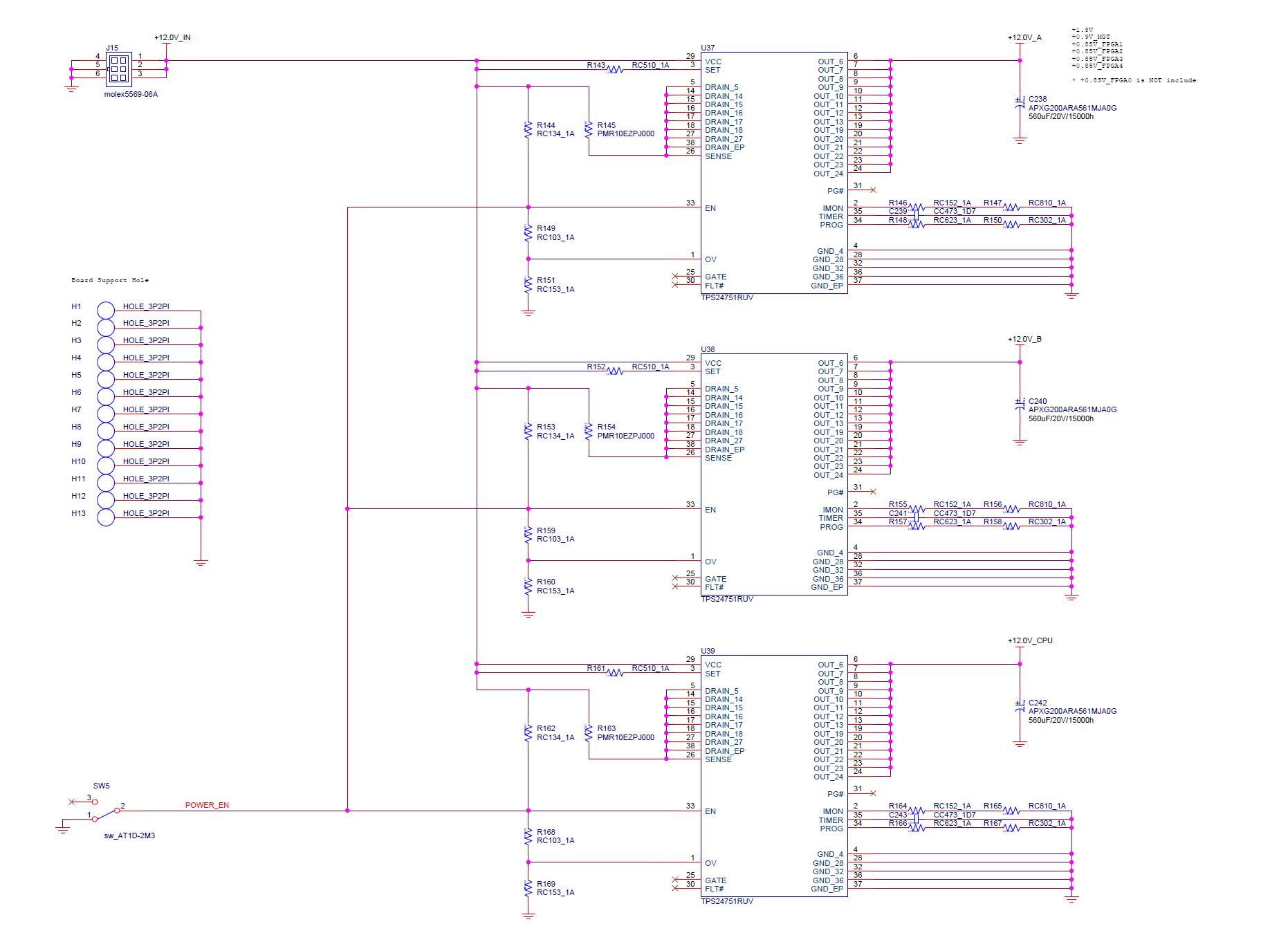

Recently I designed a board that is consume 30A main power.
Because TPS24751 is very useful, I select TPS24751 for new board too.
But TPS24751 is 10A rated, I divided the main power into three parts. (+12.0V_A, +12.0V_B, +12.V_C)
It work well in the first few time. But it seems to be broken at the end.
When last, It is very hot and look like short DRAIN and GND - very large current consume -.
I want to know why this is the result, and wonder how to prevent this result.
I upload my schematic.
Sincery.

  • Dear Rakesh.
    I am ashamed to use the application schematic in front page of datasheet.
    So I didn't consider the various parameters you mentioned.
    It was designed the same value execpt for Rsense 0.002 --> 0.000 and Cload 470uF --> 560uF
    Now TPS24751 look like broken, I cabling from (+12.0V_IN) to (+12.0V_X).
    I have SMT only one board and the board using others.

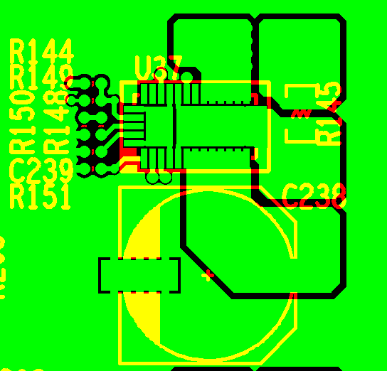

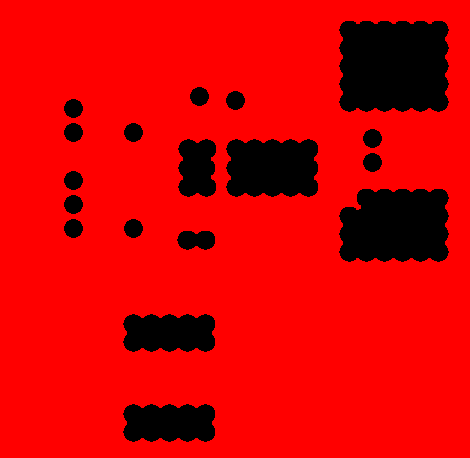

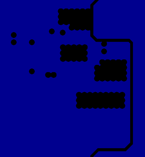

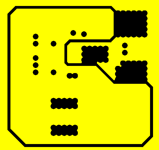

    I paste the layout below.
    L01 - TOP
    L02 = L05 = L07
    L03
    L04 = L06 = L08 = L09
    L10 = L11
    L12 (Bottom)
    Um... It seems very difficult to review layout with picture file.
    If you have any idea, I will aceept it with gratitude.
    Sincery.
  • Hi Shin,
    The device monitors the load current through sensed voltage across Rsense resistor.
    Rsense value is very critical for protection. The values given in the front page of datasheet are good for 10A use case.
    Can you test again by placing back 2mOhm for Rsense resistor.
    Best Regards
    Rakesh
  • Dear Rakesh.
    I designed the circuit like application schematic on front page, but I thought was Figure 48. Simple load switch.
    I don't monitor current and each tps24751 do not pass over 10A except broken on others part on board.
    (It is mesured 1.5A where bypass wire.)
    Although Cgate and Rgate is absent, I thought it would work well on.
    When work well gate voltage is about 25~26V, and when I think breaks, Gate voltage is never change from 0V.
  • Hi Shin,
    If you like to use as load switch, please use Cgate and Rgate to limit inrush current while driving large capacitive load 560uF.
    The following app note provides information on the same. www.ti.com/.../slua740.pdf
    Please let me know what type of protection you need for your system?
    Rakesh
  • Dear Rakesh.
    I wired Cgate and Rgate and It look like work well!!!
    It seems that it didn't work because it have larger capactive load (about 3,000uF)
    I really appreciate your help.
    To answer the your last question, I used tps24751 to protection over voltage and to simplfy power switch design.
