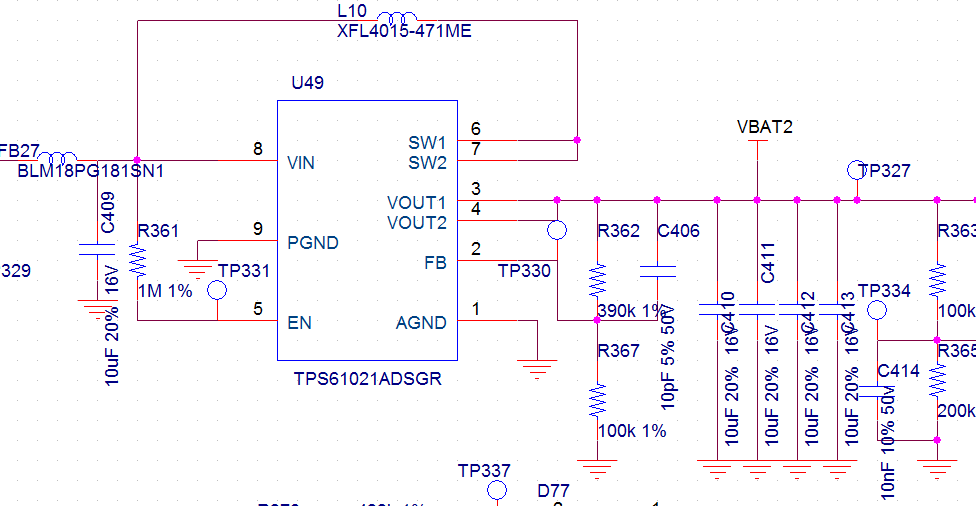

My customer use TPS61021A encounter a problem. The input equal to output. The target voltage is 4v.
The test result is as follow:
Input 3.2V, output is 3.2v, FB=1.6V , EN pin is high
The sch is as follow:

The sch is OK except the EN resistor R361=1M is a little bit bigger. please change it to 100k. But htis will not effect the output. I think there may exist some solding problem, please resolder the R362 and R367 to check it again.
Or you can also add a 4V DC voltage at the output side, then check the FB voltage again. normally, if sold well, VFB=0.8V
