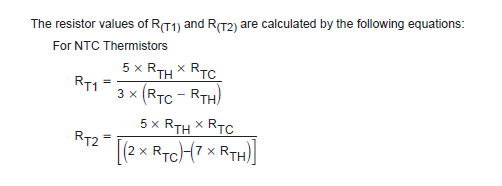

 I have used BQ2057W  in my design for batter charging application. I have used battery with NTC thermistor.
I have used reference design given in TI's BQ2057W datasheet. For Battery Temperature Monitoring, two Resistors values need to be calculated. As shown below.
W
In my case, Rth value is 7.2K and Rtc value is 8.6K. So, when I calculate Rt2  Value. I got negative resistor value.
So which value resistor is to be used for voltage divider. Any solution Regarding this.
