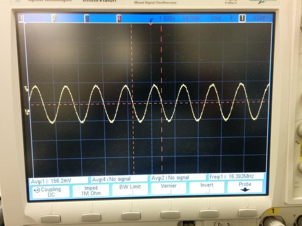

    One other thing to check is the crystal, do you have a 16.384MHz crystal connected to OSC16MIN? If so, please check that the OSC16MIN signal is getting this signal. If the PMIC does not see crystal sine wave at the OSC16MIN pin, some units will issue a reset when it detects too slow clock.

    I have attached 16.384MHz crystal in my case, Attached is the waveform for this too.
