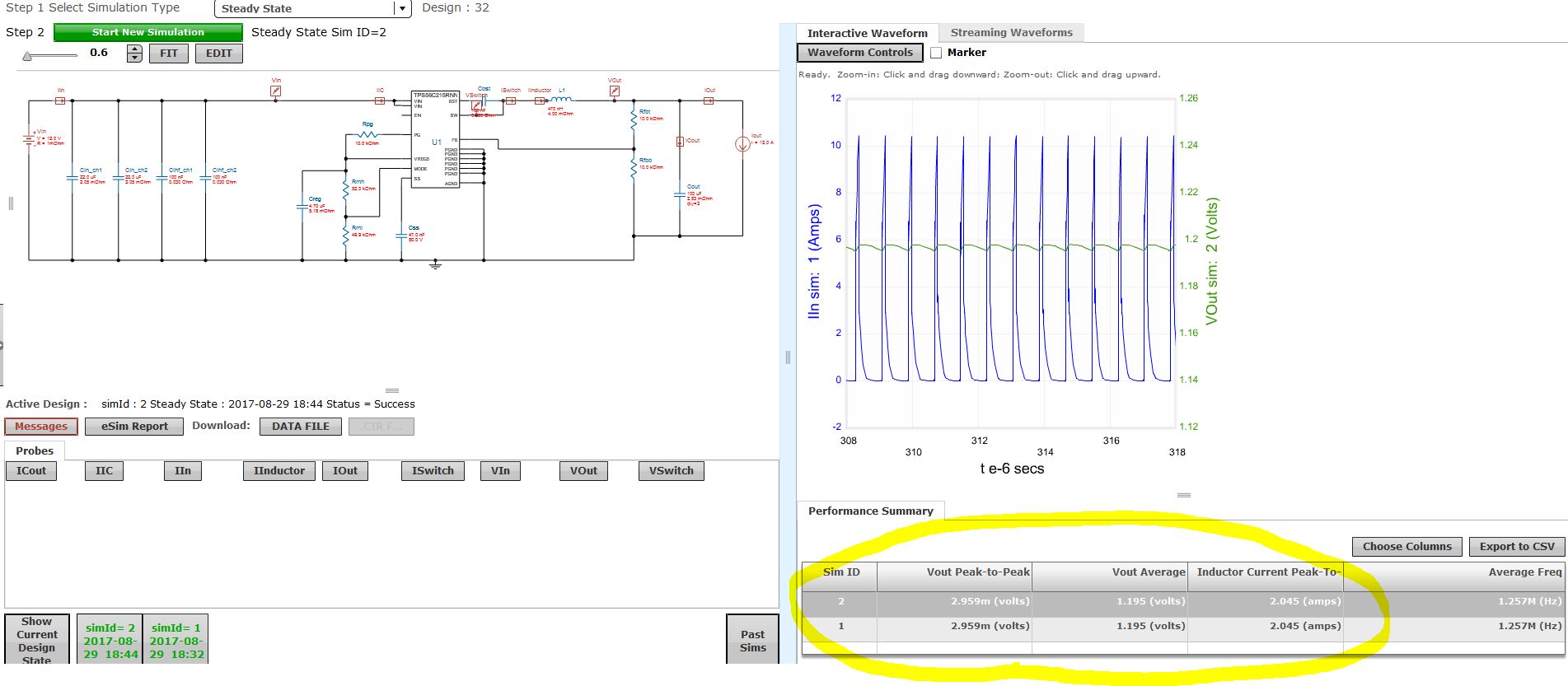

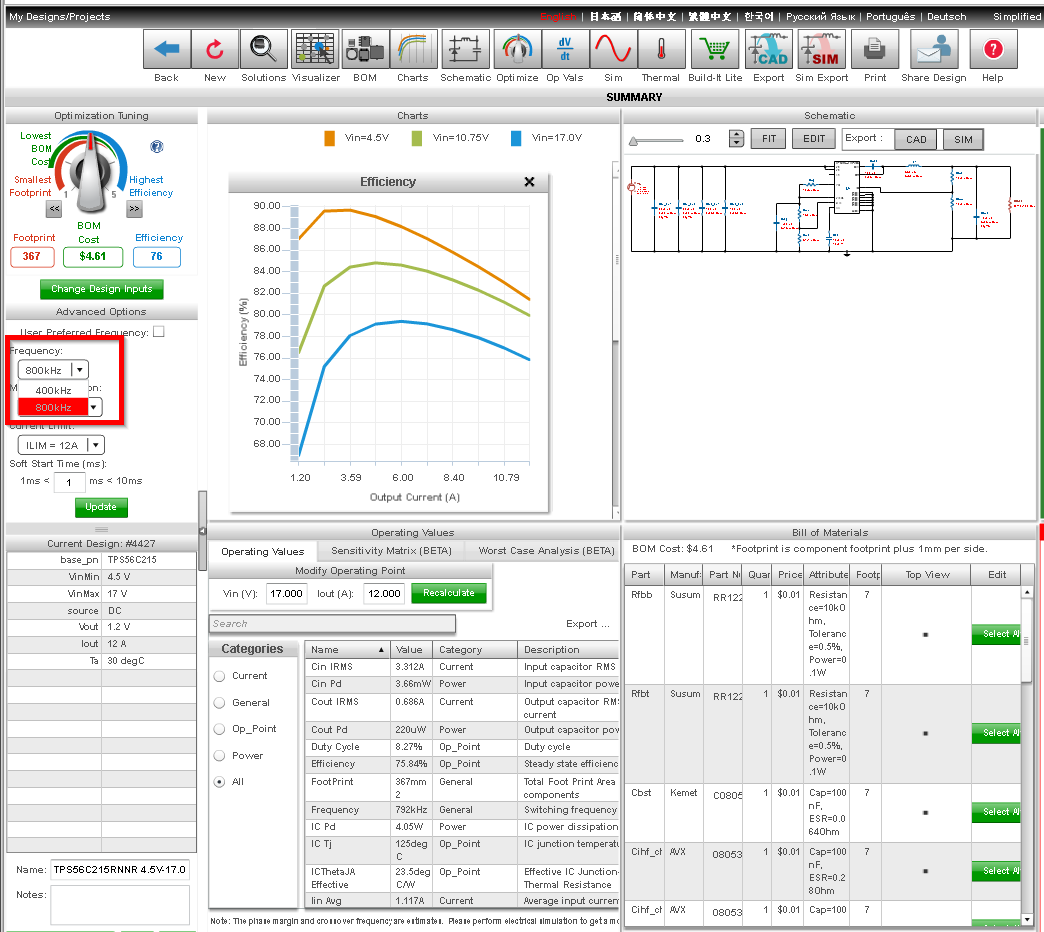

    I also have a question about it. I clicked the Op vals button and it showed my Operating values like Vental showed. One confused point in it is I exported the Operating Values, the frquency showed in it is 800kHz ,but my mode pin is selected to 1.2MHz and the time domain was also 1.2MHz.
    So the efficiency chart's frquency was based on which frquency? Thanks.
    Roy
  • Hi Roy,
    Currently on Webench we have enabled only two frequencies .i.e 400kHz and 800kHz as highlighted in below image. Efficiency will be calculated for frequency displayed in Opvals.
    Since 1.2MHz is not enabled on Webench it will show only 400kHz or 800kHz in Opvals table.
    Mahantesh

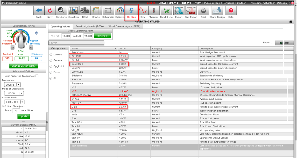

  • Hi Roy,
    1. Currently we are not displaying parameters like Iin Avg, root mean square values in performance summary.
         However you can find Iin avg, Cin Irms and Cout Irms in Opvals as shown in below image.
     2.  IC Pd includes/calculated using below equation.
       a. If High side FET is on, below is the IC_Pd loss calculation equation.
    IC_Pd = {Pdiss_IC_quiescent +  Pdiss_FetHS_Conduction+Pdiss_FetHS_GateCharge                                  +Pdiss_FetHS_Rise+ Pdiss_FetHS_Fall+Pdiss_FetHS_Coss+Pdiss_FetLS_ReverseRecovery }
    b. If Low side FET is on, below is the IC_Pd loss calculation equation.
    IC_Pd = {Pdiss_IC_quiescent + Pdiss_FetLS_Conduction+Pdiss_FetLS_GateCharge +Pdiss_FetLS_Coss +Pdiss_FetLS_Diode +Pdiss_FetLS_Fall}
    Where, Pdiss= Power dessipation
                  FetLS= FET low side,FETHS=FET High Side.
    Mahantesh
