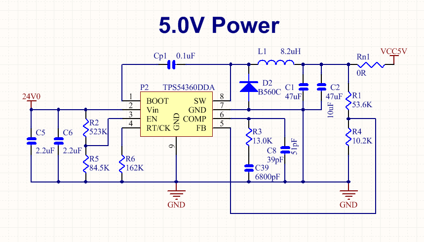

I use tps54360 output 5V to am335x bbblack .the tps54360 output 5V normal ,but the board can`t start normally.the power led coruscate.
