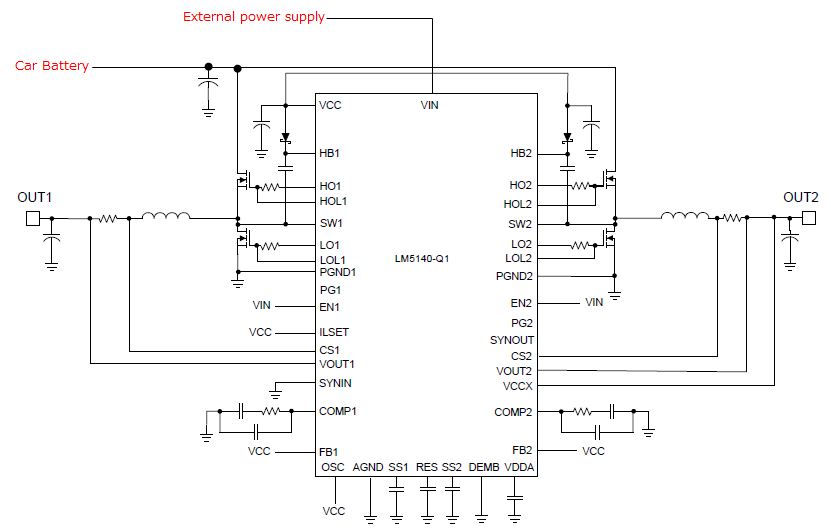

We got a question from customer about LM5140-Q1.
Could you help us?
[Question]

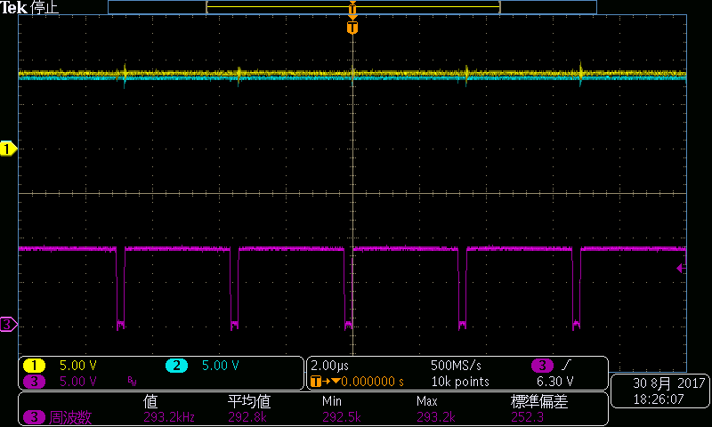

If the off time of the high-side FET is beyond the minimum value(100ns max), what is the behavior of the IC? Our customer found the phenomenon that the IC reduce switching frequency. Is this phenomenon correct?
Vin=8.5V, Vout=8V, Iout=3A, setting fsw=2.2MHz
