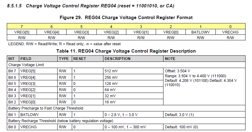

Dear Tier
I know the Recharger Threshold can set by REG04(bit 0). It has "0 - 100mV" and " 1 - 300mV "
The question is how to set the Recharger Threshold become other value, for example 500mV or 700mV or....
