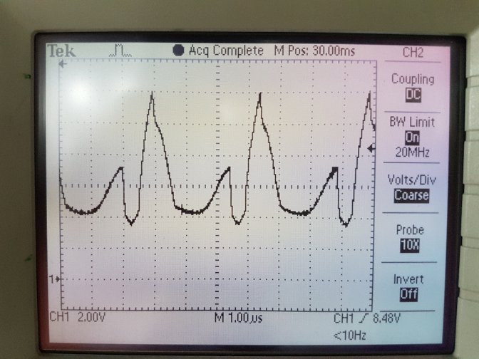

I have a power supply design using the
 LM5088-1 Buck controller.
 The TI web design gave me a design
 (24V6A.pdf).
 The design on my board is also included  (LM5088PWR.pdf).
 The input voltage is from 42V to 59V.
 The problem is the output voltage is
 only 7V, not the 24V I need.
 Changing R32 to ~15K gives me a higher
 output voltage ~12V.

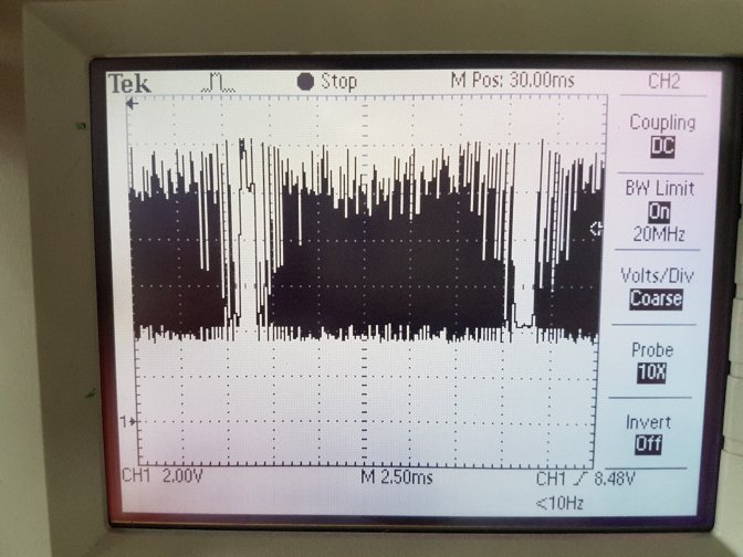

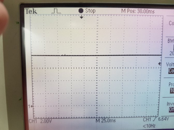

 The strange thing is the MOSFET gate
 signal looks wrong.
 It never goes above 5V and never goes
 below 1V.
 The gate drive on this buck power
 supply should go up to close to 48V and down to close to  0V.
 Can you give me suggestions on how to
 make this LM5088 based design work?
Attached files are the schematic.
