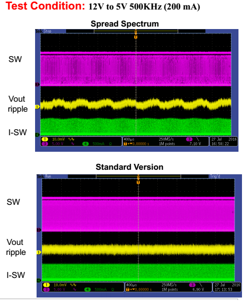

LMR14030-Q1: Spread spectrum swing frequency
Part Number: LMR14030-Q1
We got a question from customer about LMR14030-Q1.
Could you help us?
[Question]
How much is the swing frequency of spread spectrum under the following condition? They found about 8.3kHz Vout ripple. They are considering this ripple is related swing frequency. Do you think this phenomenon is related swing frequency?
 Vin=12V
 Vout=5V
 Iout=2.4A
 fsw=2.2MHz
