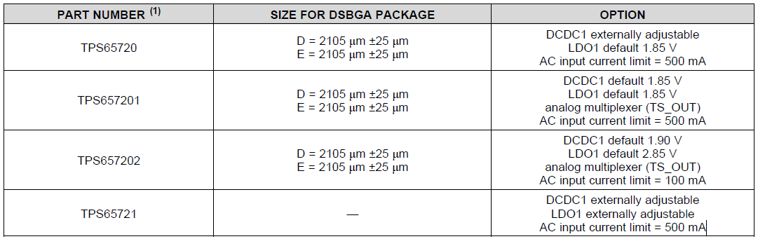

  • John,
      Ricks statements are correct. There is no way to reduce component count unless you can live with fixed voltages. In the image below you have a few options. If you choose a fixed voltage you can remove two resistors and a filter cap for the feedback circuit on that rail.
    Finding a buck/boost with a charger is nearly impossible. there are several buck/boost chargers but they typically don't have the regulator internal.
