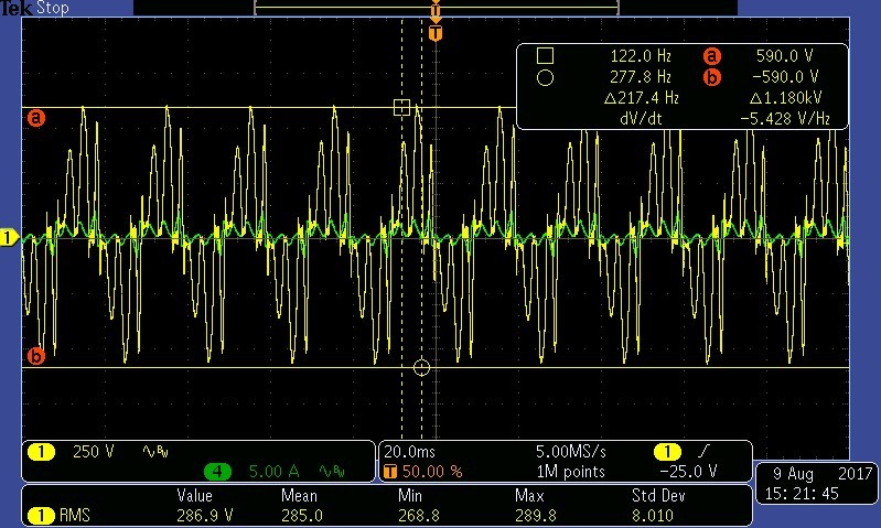

Hi Support,
Do you have 143W isolated-flyback driver solution for below spec?
Below are the Driver specification:
143W Isolated Fly back (continuous- conduction mode)
Input Voltage:198Vac ~265Vac
Output Voltage :90Vdc~168Vdc
Output Current: 850mA
If yes, is it OK when test your solution with gasoline AC generator 220Vac?
OK means driver will not causing generator AC voltage distorted.
As during streetlights installation, installer will test the streetlamp with gasoline AC generator first.
We working looking for driver solution can be working fine with gasoline AC generator.
Our existing driver is working fine with AC source and wall plug, but when test with gasoline AC generator, the driver will causing generator AC voltage waveform distorted as below picture,
and due to spike voltage too high, it will burn the MOV after around 30seconds.

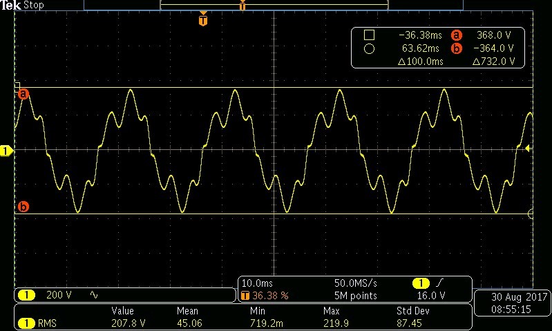

But test with other application drivers, the generator AC voltage waveform is OK as below picture:-
