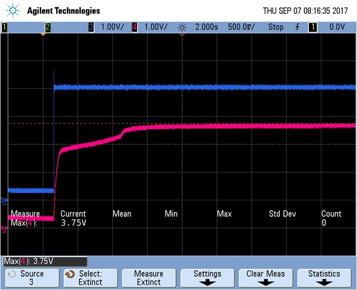

1. Removed battery
2. After the OUT voltage is below 500mV (0~500mV), and then battery(4.1V) connect.
3. Desired the OUT voltage about 4.1V, But OUT voltage is about 3.75V (Please refer below waveform)
( Blue = Battery voltage / Red = OUT voltage )

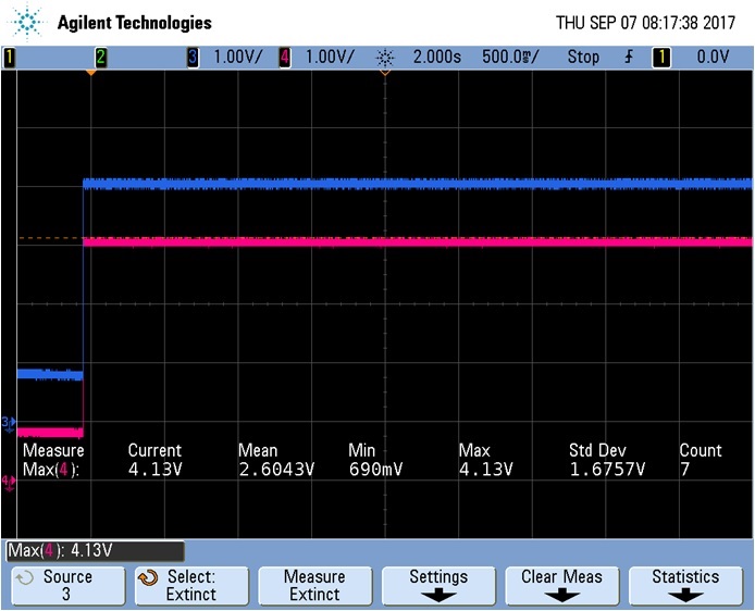

Normal operation)
1. Removed battery
2. Before the OUT voltage drops below 500mV (that is, OUT Voltage is still above 500mA) and then Battery(4.1V) connect.
3. OUT voltage is about 4.1V. This is normal.

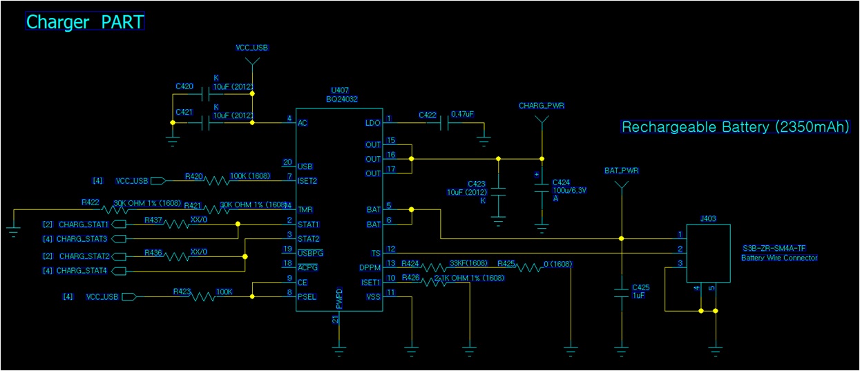

Question)
Why OUT voltage drop? and How can I debug?
Please help me and let me know hint or debugging point.
Refer attached schematic and waveform.
