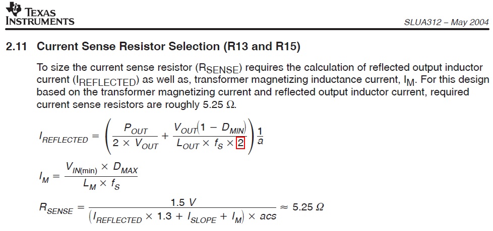

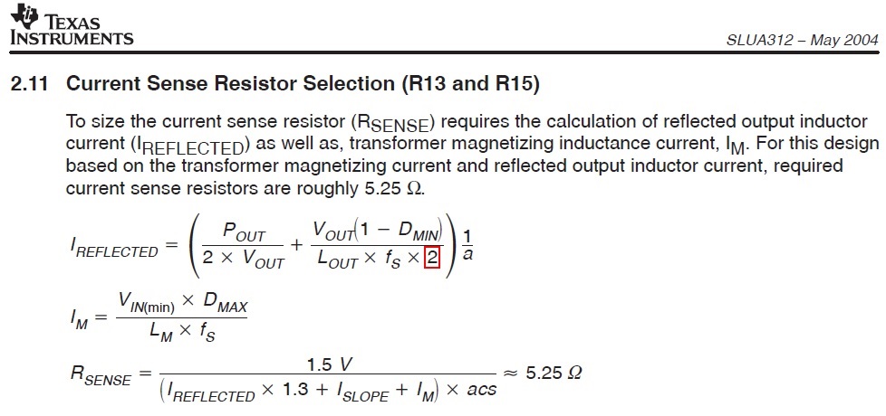

Hello, there is a problem with the SLUA312, see page 11
I use the red label is not the 2 should not appear in there, because this is a reflection of current single channel, the frequency should not be multiplied by 2?
