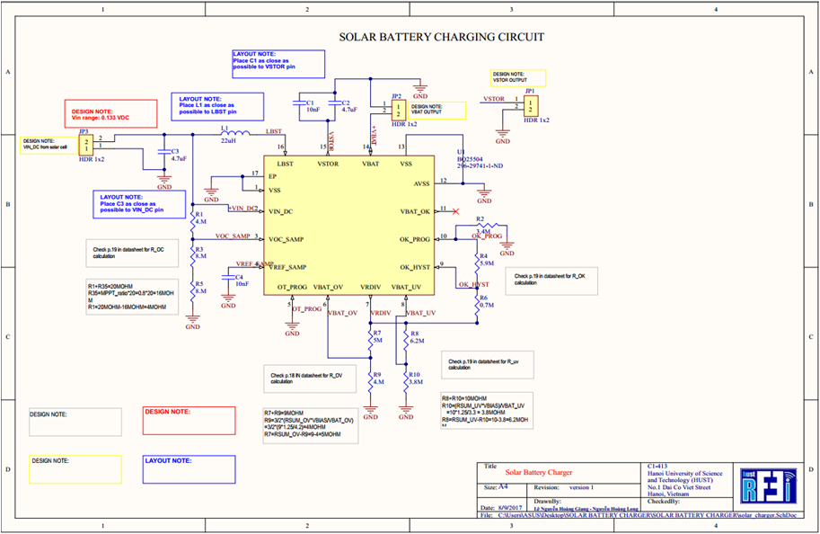

I have some problems with my new battery charger board. I used a solar panel with Voc=4V and Isc=1mA to supply the board. The board is set with VBAT_OV=4.2V and VBAT_UV=3.0V.
The problem is when i measured the Vin voltage of the board, the meter showed only 1.8V. Next i measured VSTOR and VBAT pin they were only 1.3V.
Here is the schematic:
    If VSTOR is below 1.77V, the IC is still in Cold Start mode. Since VBAT < VBAT_UV, there will be no output since the FET between VBAT and VSTOR will be off.
    Raheem

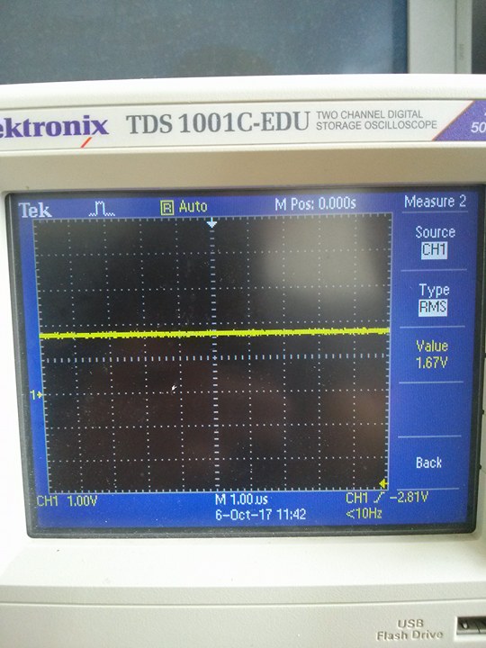

    When I placed the solar panel in the room in which Voc=3.6V and Isc=0.07mA, I got VBAT = 1.67V and VSTOR=1.9V

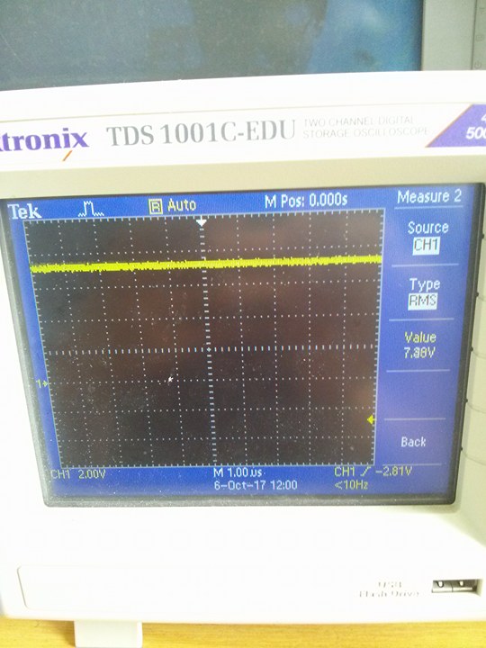

    When I placed it outside in which Voc=4.5V and Isc=1.5mA, I got VBAT=7.3V
    I think the current plays an important part in the boost converter's operation. Could you suggest any idea to improve this situation?
    2. I selected an inductor different from those which recommended by datasheet but still had the same inductane value 22uH. Are other parameters such as current rating, saturation current or also important or only the indactance? The inductor i choosed is MLZ2012N220LT000 which has 300mA current rating and 70mA saturation current.
    Here are some scopes of VBAT
    Based on the VBAT_OV setting being equal to 4.2V, i don't expect the battery voltage to be above that so i'm surprised that VBAT is equal to 7.3V. Regarding the inductor selection, you'll have to follow the rule stated below.
    Raheem
