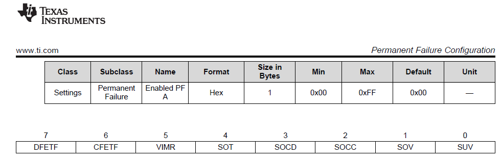

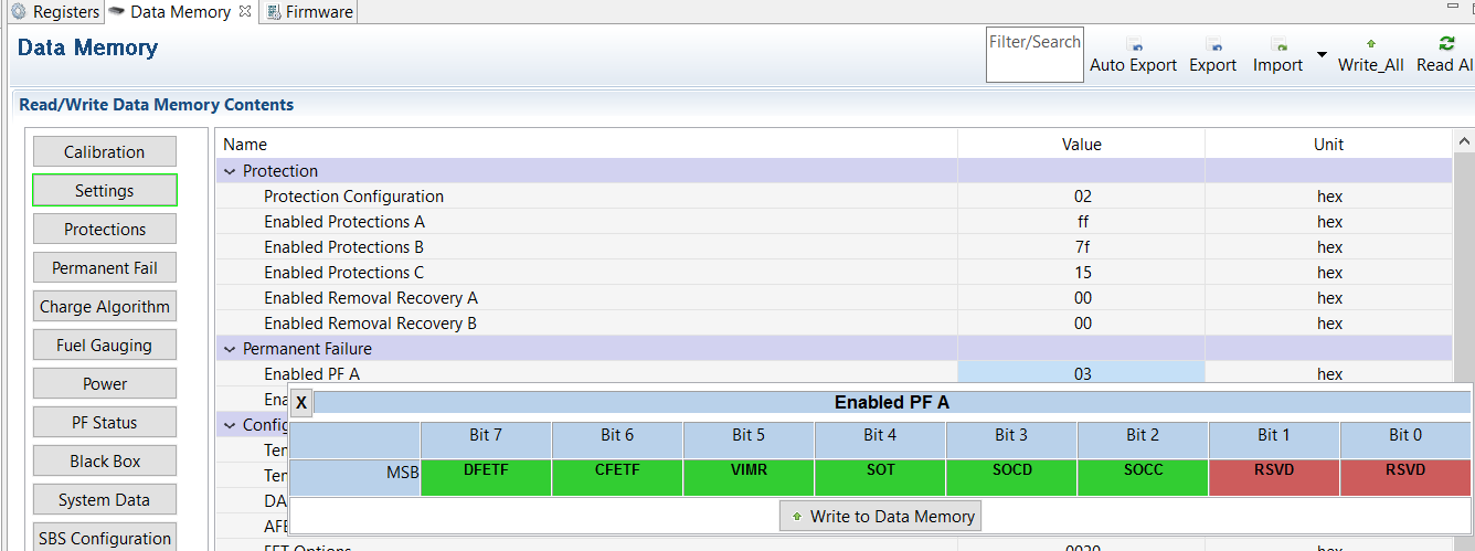

My AFE SUV threshold doesn't work (2000 mV)
Maybe I have a issue about Permanent Fail / Enabled PF A register.
I don't have acces to bit 0 and 1 .... They are RSVD but BQ78350-R1 application Note specify that bits are for activate PF for SUV and SOV.
Do you know an solution, because my Cell voltage is locked to 1750 mV on the AFE companion...?
