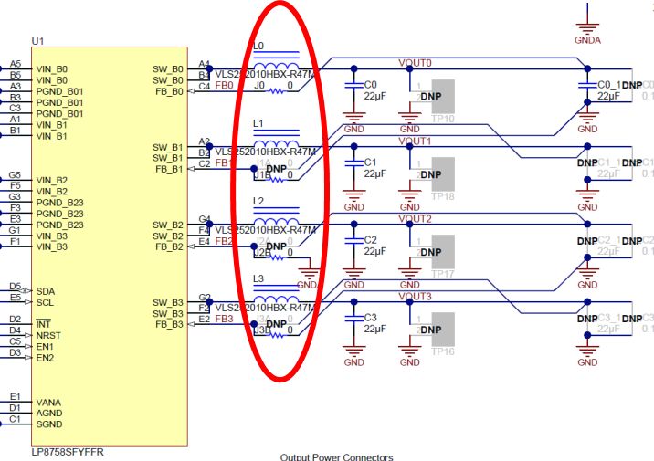

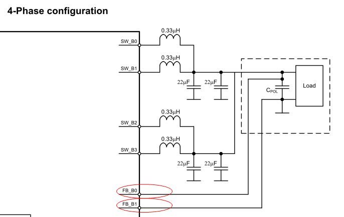

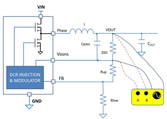

Now the customer consider to evaluate LP8758-B0 and they ask how to measure loop gain and phase margin by using EVM. So please let me know where the injection resistor should be added and also the measurement point on EVM.
