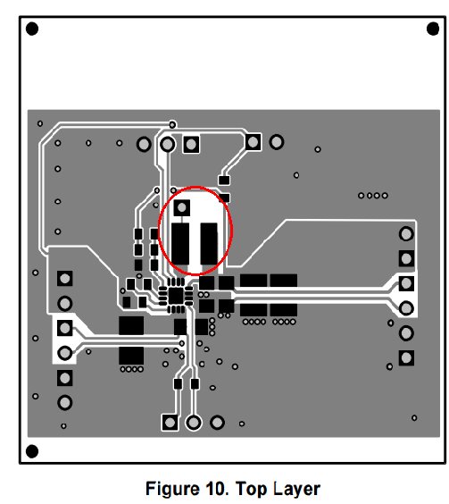

TLV62090 demo PCB not fill copper at bottom of inductor, Why?

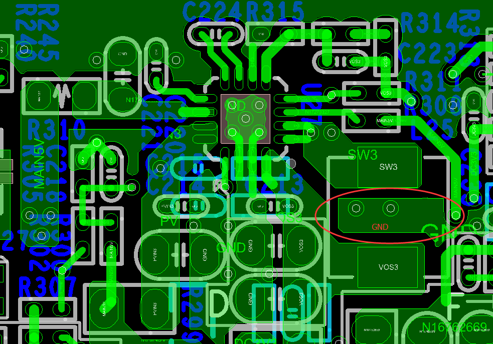

hi: Emmanuel
In my PCB, I fill copper with GND at bottom of inductor, I think that can reduce inductance radiation for EMC...
But Somebody think that reduce value of L(Q), And make radiation interference to the ground, It's bad for buck...
I find TLV62090 demo PCB also not to fill GND copper at bottom of inductor, I want to know why?
