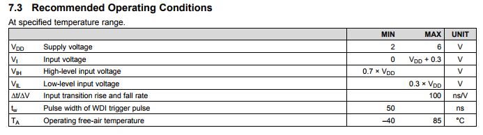

    The above condition is verified. If VDD is removed, and WDI is still pulsing, the VDD pin can have ringing that matches the signal at WDI.
    Please note the Recommended Operating Conditions table 7.3
    The Input voltage at WDI is recommended to be between and VDD + 0.3V so this means if VDD is removed and 0V then WDI should be ~0V also. The WDI pin should not be above 0.3V higher than VDD or there can be ringing on VDD.
    If there must be active pulsing WDI while VDD is removed, insert pull-down resistor (shown in Figure 8 on page 13) or a decoupling FET with the gate to VDD, source to WDI at device, drain to WDI signal (RM_WDI2) so that the WDI signal will never reach the WDI pin unless VDD is high to turn on FET.

  • Iven,
    1. Try with only resistor first. Resistor provides easy and quick and cheap solution. Refer to Figure 8 in datasheet.  www.ti.com/.../tps3813.pdf
    2. If resistor doesn't work because of the strength of the signal, the decoupling FET should work in all cases. Try the resistor pull-down solution first and if no success then try FET solution.
