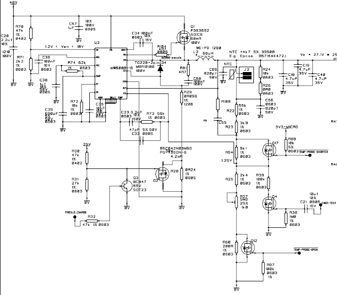

I have a problem with a buck converter used for charging a battery. It seems that when the battery voltage is very close to the charger voltage, the voltage regulation does not operate as expected. The feedback pin remains below the reference voltage. After some investigation I think the problem comes from an insufficient charging of the bootstrap capacitor. When the converter is running dry the regulation is fine and the amplitude of the command is fine.

    PS: there does appear to be a lot of switching on the feedback.  You may want to check that the FETs are working and are being programed as expected and not driving the FETs into their linear region?

    • Multiple switching on the feedback:
    R28, R54, R60 are now shorted and R39 removed => no change detected.

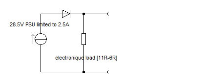

    • The problem seems linked to the type of load connected to the output of the charger:
    When connected to an electronic load, the faulty unit works fine and the voltage is held constant for the expected current range [0 – 1.4A].
    When connected to a load similar to a battery, there is a voltage range for which the feedback seems inoperative. When load voltage falls below ~25V the switching resumes and the charger can then properly be loaded. The problem was first spotted on a set of charged batteries and reproduced using the load below:
    I do not understand how this this kind of load could interfere with the feedback.

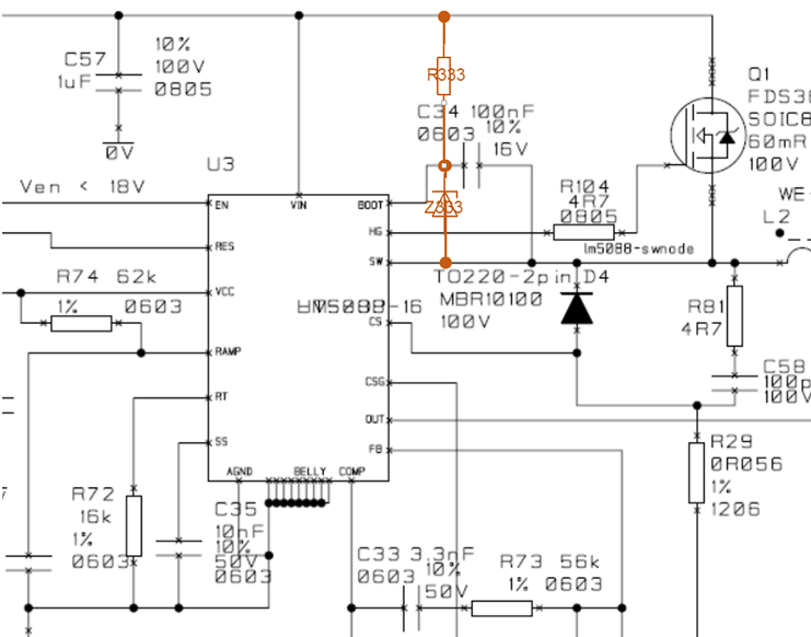

    I think I have now a better understanding of what the problem is.
    • At some point the battery voltage gets high enough to generate a feedback which causes the converter to stop switching.
    • When the switching is stopped, the charging of Cboot should be made by the pre-charge circuit. Unfortunately, when the battery is connected, it seems the pre-charge circuit fails to pull down the SW pin low enough to properly charge Cboot causing the driver being disabled.
    Could you confirm that is a plausible scenario?
    Could you tell me what would be the best option to keep charging Cboot in this case
    I was thinking adding a resistor and a zener like in the attached schematic.
    Could you tell me if that is a valid option?
    Best regards
    Gilles
  • Hello Gilles,
    Your assessment is correct.  If the output voltage goes above the Set point the converter will stop switching, when it stops switching Cboot will discharge.  I believe your circuit will work provided there is enough Vin head room over vout to Charge the boot cap.  I would make the current very low (uA's) and test to see if this fixes the issue to the needs of your application.
