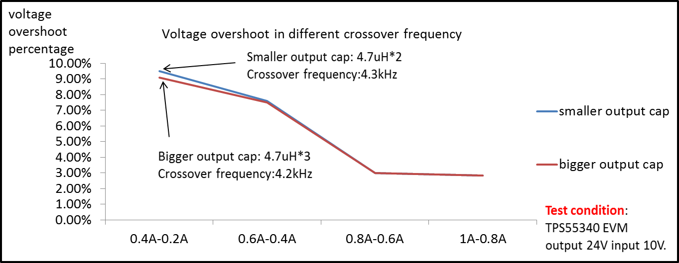

I do the TPS55340 experiement in different output capacitor, but the output as follow:
I want to know why a bigger output capacitor have no different with small output capacitor in control overshoot in higher output current.
You can see in the small output current, the bigger output capacitor have a better performance to control the overshoot.
I tested the overshoot in the various output current, I can see the crossover frequency is higher in bigger output current.
Output Current
0.01A
0.15A
0.5A
Crossover frequency
1.2kHz
2.5kHz
4kHz
  • Miller,
    Are you talking about the over shoot due to a load transient (Load step)? If so please let me know what the change is on the load current.
    Also please make sure that you are probing the output voltage properly with a short ground lead and directly at the output of the EVM.
    You can also contact me directly for more any more questions.
    Garrett
