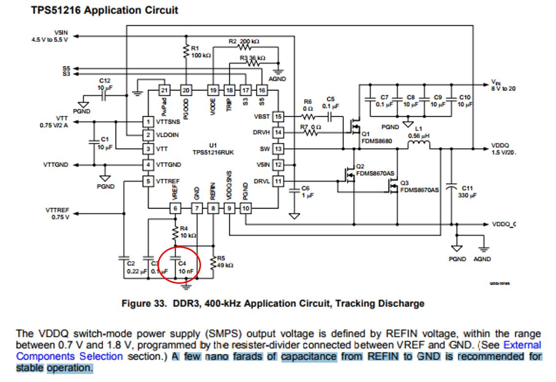

Hi all.
Please check the attached file.
My customer use 0.22uF capacitor from REFIN to GND, however TI recommend the capacitor is a few nano farads for stable operation.
-Datasheet comment
" A few nano farads of capacitance from REFIN to GND is recommended for stable operation."
If we use large value capacitor. is there any problem points?
Please tell me the reason why the capacitor volue is a few nano farads.
Sho
  • Hi Sho,
    If the large value capacitance is placed between REFIN and GND, the REFIN will rise up slowly during power on.
    That means the VDDQ startup time will be longer.
    Other than that, 0.22uF should be fine during normal operation.
    Qian
  • One limitation of REFIN capacitor is the REFIN voltage needs to reach the target value before PGOOD comparator enabled.
    The below informaiton is capture from datasheet page 15.
