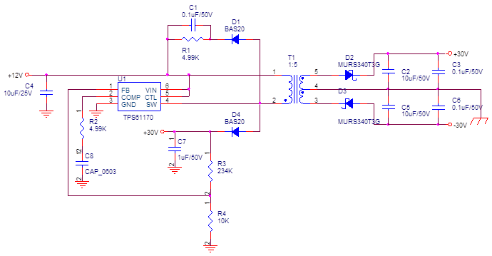

May I know TPS61170 can implement Isolated PSR topology?
It can be used in the flyback applicaiton. Be sure the SW volatge is below the Vmax allowed in the datasheet. what is the maximum output power in this application? The peak switch current is only 1A.
It is OK. But since the seconday voltage is not regulated by the FB pin, you need to be carefully calculate the turns ratio, 1:5 is too big and will make the seconday output voltage higher than the target. did you add a voltage clamp circuit like linear regulator followed by the +-30V output?
