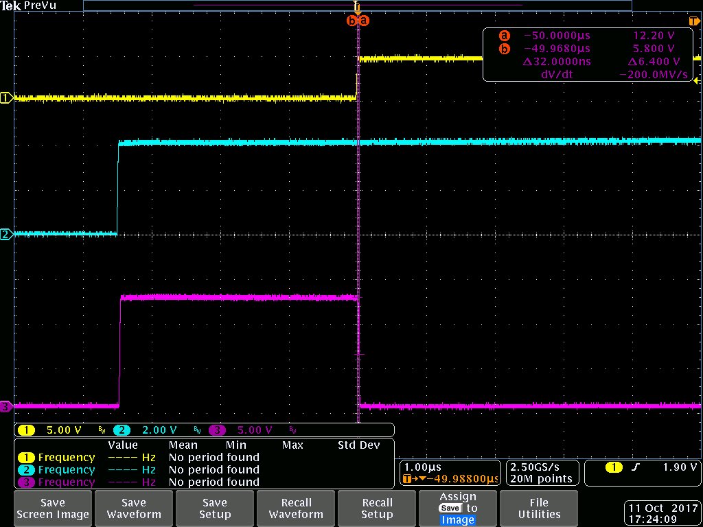

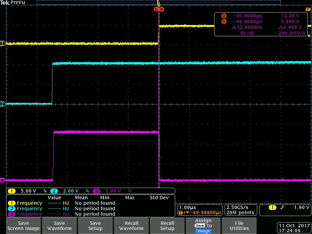

  • Hi Radar,

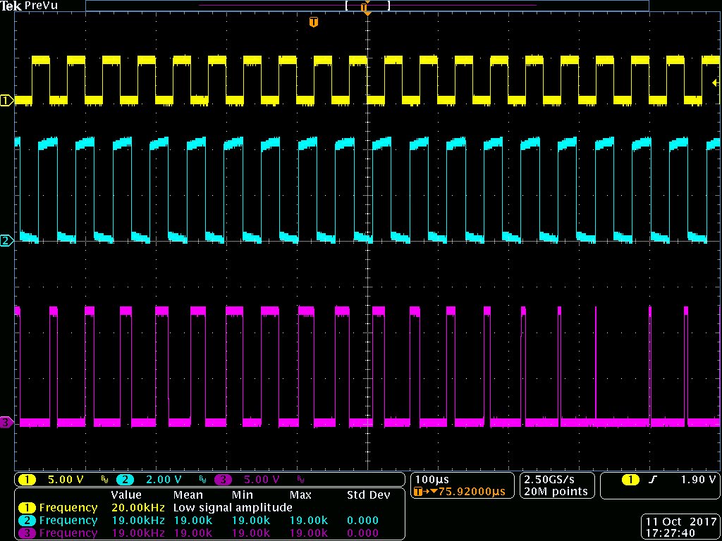

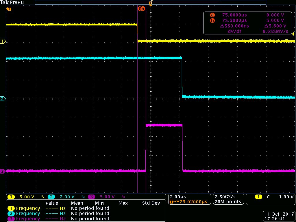

    I was able to capture the following waveforms on the bench: [ Channel 1 (yellow): IN, Channel 2 (cyan): EN, and Channel 3 (magenta): LO ]
    I used 100kOhm for R_DT which
    test conditions:
    IN: 20kHz, 50% duty cycle pulse
    EN: 19kHz, 50% duty cycle pulse

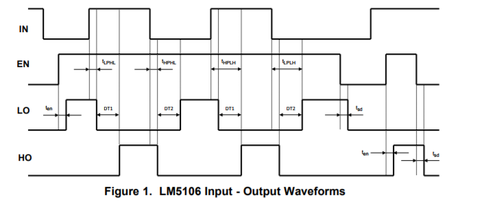

    I was able to confirm values from figure 1 in the datasheet despite IN and EN being out of sync.
    regards,
    Mateo

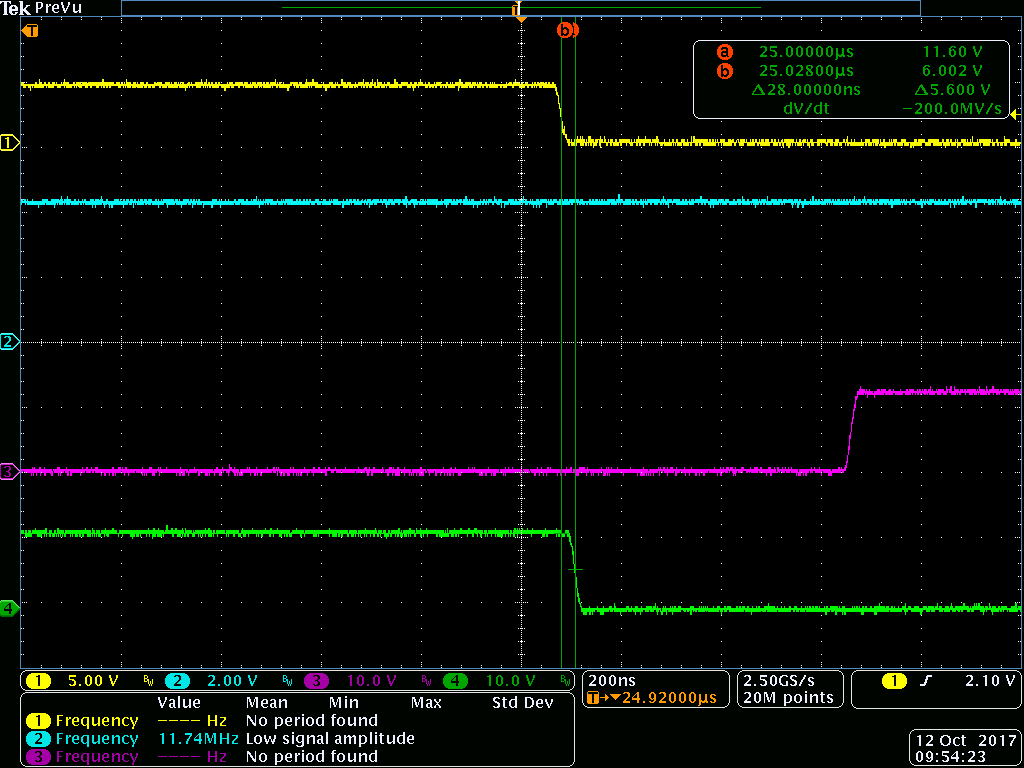

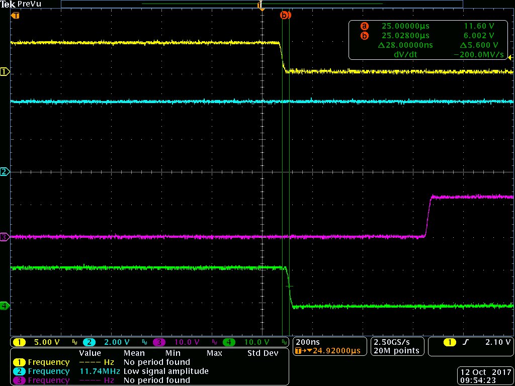

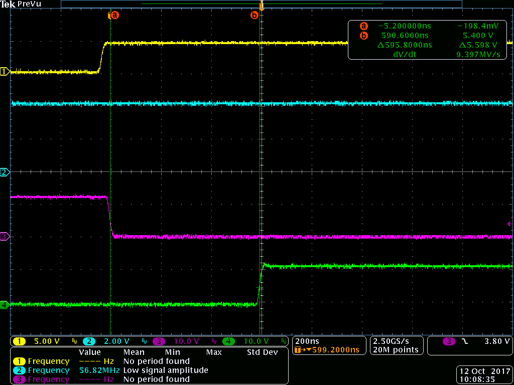

  • Mateo,
    So this piece looks great.... but that's what was expected. What I was chiefly concerned a out as outlined in the initial post was the HI side output; because that's the output with the level shifter. If you could add the fourth channel with the HI side output to the plot I think we'll be there.
  • Hi Radar,

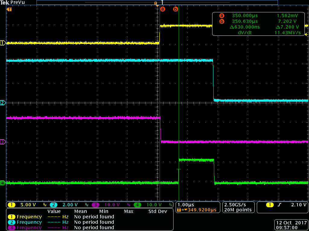

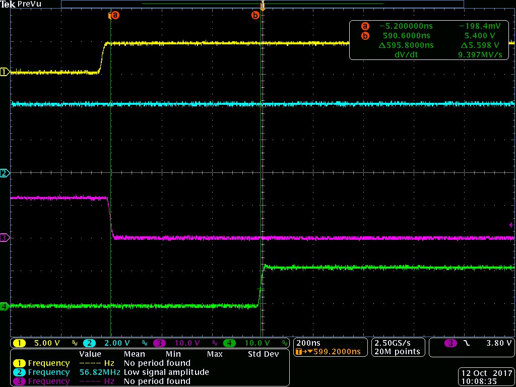

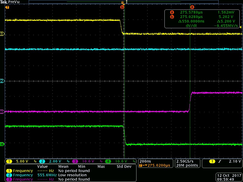

    No problem. The following scope captures are under the same condition but have the 4th  channel (green) connected on HO:
    HPHL measurement:
    t_HPLH measurement:
    DT1 measurement:
    DT2: measurement:
    I hope these scope captures suffice proving the operation with a 20kHz input and a 19kHz signal on the enable.
