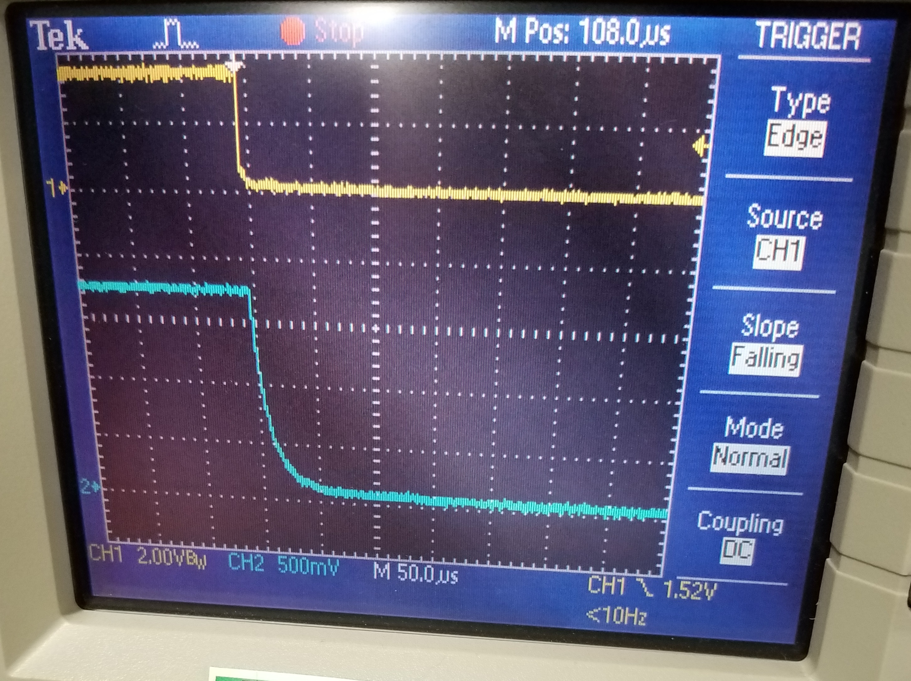

TLV62585 has output discharge circuit with Internal SW of 10Ω Rdson.
In shutdown mode, Figure.16 in datasheet, output voltage has undershoot about -0.3~0.4V.
Is it reason discharge is too early, because internal resistance is as small as 10Ω?
and , is there a way to make it smaller ?
