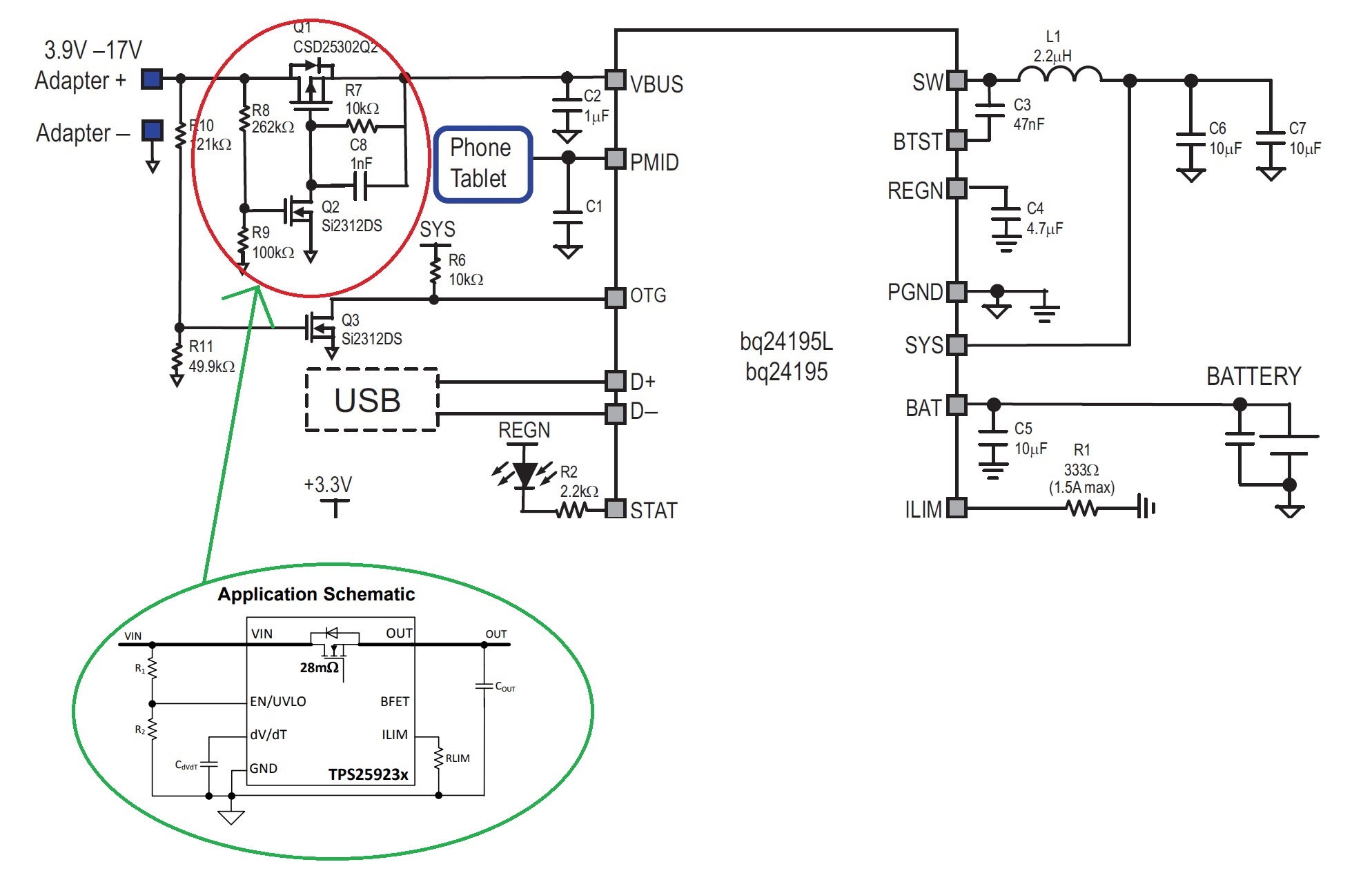

BQ24195: Inrush limiting circuit requirement
Part Number: BQ24195
Application circuit for BQ24195 used two FETs (pFET and nFET) for inrush limit.  Wondering if we can use TPS259231 which is OVP and has feature to control dV/dT (voltage ramp time) ?
The section of the application circuit and planned replacement option highlighted below.
Please let us know if there are any requirements or errata during startup or inrush limit ?
